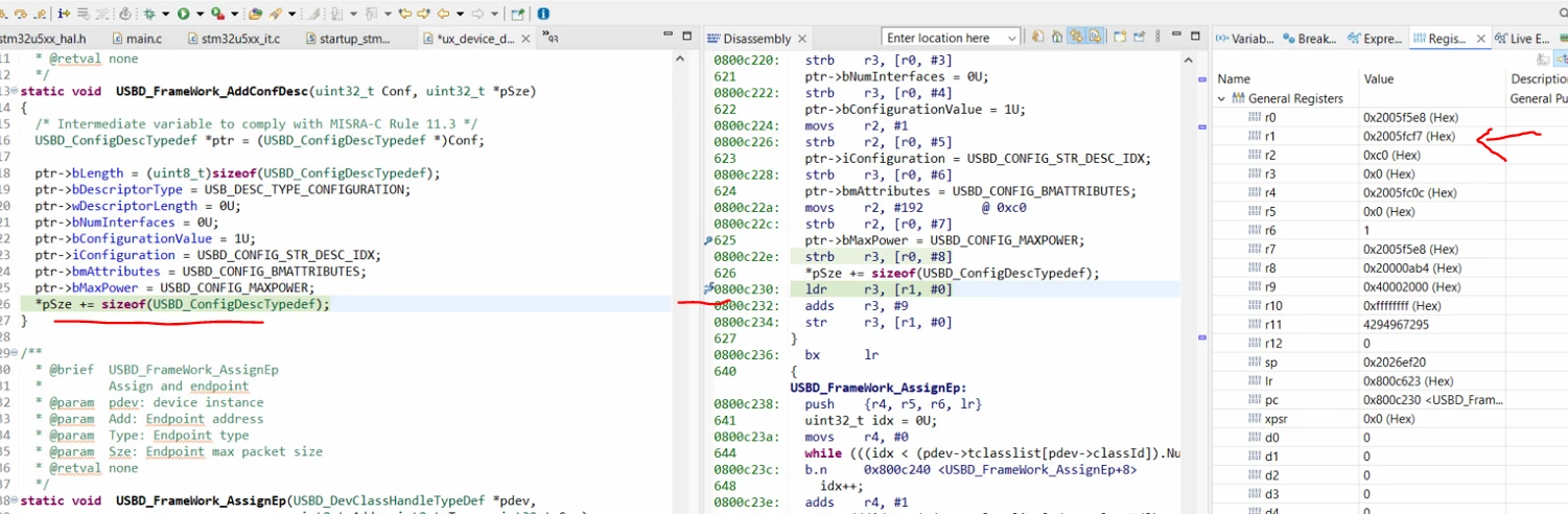

in ux_device_descriptors.c,
I see a hard fault at this highlighted line
static void USBD_FrameWork_AddConfDesc(uint32_t Conf, uint32_t *pSze)
/* Intermediate variable to comply with MISRA-C Rule 11.3 */
USBD_ConfigDescTypedef *ptr = (USBD_ConfigDescTypedef *)Conf;
ptr->bLength = (uint8_t)sizeof(USBD_ConfigDescTypedef);
ptr->bDescriptorType = USB_DESC_TYPE_CONFIGURATION;
ptr->wDescriptorLength = 0U;
ptr->bNumInterfaces = 0U;
ptr->bConfigurationValue = 1U;
ptr->iConfiguration = USBD_CONFIG_STR_DESC_IDX;
ptr->bmAttributes = USBD_CONFIG_BMATTRIBUTES;
ptr->bMaxPower = USBD_CONFIG_MAXPOWER;
*pSze += sizeof(USBD_ConfigDescTypedef);

Using default 13.3 toolchain that comes with STM32Cube IDE 1.18.0 , I see the issue at later point.
If I use local toolchain sysgcc (arm-eabi-none-*) , then I see issue at former with "-m-no-unaligned-access" and later with "-maligned-access"
SanshAuthor
Mar 13, 2025 2:23 PM UTC
with -mno-unaligned-access flag
