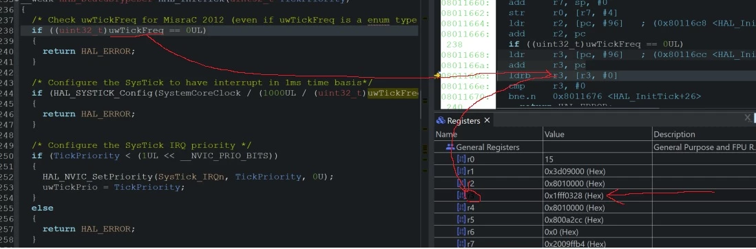

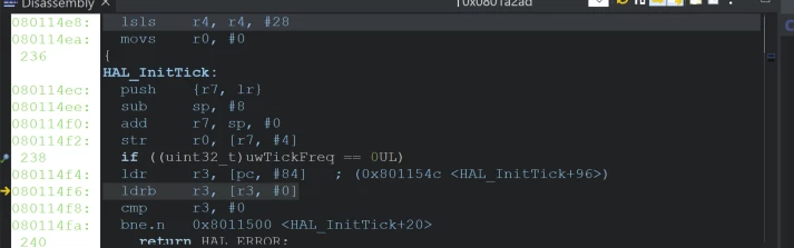

  3. When it reaches the function HAL_Init inside main the application firmware goes into hardfault upon accessing a global variable, whose loaded address is outside ram memory spaceinstruction that triggers hardfaultinstruction that triggers hardfault
    1. Funnily enough, this exact variable location is properly displayed by the expression monitor
At this point I think I am maybe missing something regarding global variables relocation, or am I doing something else wrong?

    The assembly code you showed looks a bit odd, specially the "add r3, pc" line.  Does that source code generate the same assembly without the -fPIE flag?  Though even subtracting out the PC value it STILL doesn't give the correct address.
    August 11, 2023
    • In the newer firmware (the one without fpie) I do copy rodata from flash to ram, in the older it didn't
    • in the current firmware (no fpie) the global variable address is correctly fetched, there is no "add r3, pc" it loads the variable address adding a fixed offset to the pc
    Besides why fpie was shifting the load addresses in that manner, I would like also to know how come the code without fpie is still somewhat position independent as I see that functions are called and jumps are performed always relatively to the program counter!

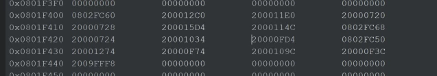

    Another Update: regarding my first firmware, the one with -fpie, I now notice that the disassembly loads the global offset table exactly 0x10000 away from where it is actually located. 0x10000 is coincideentally the offset at which I load the firmware with respect to the original linker placement....
    So I wonder, it looks like the program expects the GOT to be placed relatively to the PC with a fixed offset, but if the firmware gets uploaded in a different place than the linker's expected location, the GOT location calculated in that way becomes invalid.
    What is the point of having position independent code if the global offset table is loaded in a position-dependent manner?Am I missing something?

    So, the problem now seems to be that static variables are somehow not listed by the .got.
    When trying to access one of these static zero-initialized variables (so living int he .bss section) , the program goes into hardfault because it loads it from the wrong address.
    This is the content of the .got section and since .bss starts at 0x20000f20 and ends at 0x200015d8 you can see several entries belong to the .bss section, but others do not appear, like this one below

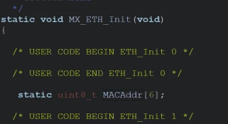

    Which is this static array
    When the program tries to access this variable it does so at 0x1fff15d8 whic is exactly 0x10000 away from where it actually is ( and 0x10000 is the offset by which I upload the code to test the position independence).
    This is because said variable is loaded by adding an offset to the program counter PC, if it were to be loaded via GOT this would not happen!
    So why are local static variables not addressed via GOT while global variables are? is there a way to ensure GOT coverage for all static variables?

    Update:
    It turns out the solution is to DISABLE the pic-data-is-text-relative option adding -mno-pic-data-is-text-relative,
    source gcc board
    Now the local static variables are addressed (and added) to the global offset table just like global and global static variables!
    I don't know why the other stack overflow answers suggested the exact opposite...either a mistake or just different use case, anyway do not use -mpic-data-is-text-relative ! Disable it with -mno-pic-data-is-text-relative.
