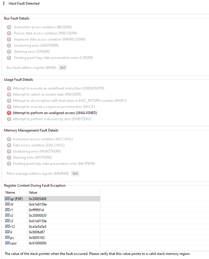

HardFault on attempt to perform unaligned access on ldr.w and blx.w instructions
I am getting UNALIGNED HardFault (attempt to perform an unaligned access) on ldr.w and blx.w instructions (as seen in disassembly when debugging). I am using STM32CubeIDE with the standard toolchain for stm32 (arm gcc, Thumb2).
I am importing a library (which I am also building with the same toolchain), in which the errors are occuring.
Can I tell the compiler to not create unaligned addresses? Or do I have to change the source code of the library?
I have tried compiling with -mno-unaligned-access.
Cortex-M-specific toolchains tend to come with settings which do generate aligned addresses. Howevr, you can't generally prevent the *user* to generate unaligned address accesses. simply by some pointer juggling.
Debug the hardfault in the usual way (walk back manually through mixed-C-disasm while observing registers' content) to find out exactly what source lines caused the unaligned access. Post it here for further discussion.

Show the actual code that's faulting, the registers, and the instructions.
It should be more apparent as to what's going on.
Bob S
December 6, 2022
And @Community member​ 's answer still applies. See what code is that the given PC address and see if you can determine why it generated the fault.
Generally the F7 supports unaligned access except for LDM, STM, LDRD and STRD instructions. There is a bit in the CCR register that can enable unaligned access faults when they otherwise might be allowed. See PM0253.
