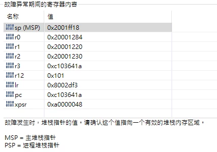

I am currently working on a project using the STM32F407G-DISC1 development board and STM32CubeIDE. The goal is to analyze the data and print the respiratory rate after continuously collecting ADC data for 10 seconds. However, I encountered some problems and hope you can help.
First of all, when I press the button for the first time, the pointer points to the "HardFault_Handler"; and when I press it for the second time, although the ADC value can be read, there is no printing in the ITM window. The fault analyzer shows the following information:
1.Bus: Memory management or usage failure
2.Instruction access conflict
3.When the fault occurs, the value of the stack pointer, please make sure this value points to a valid heap memory area
MSP = Main Stack Pointer
PSP = Process Stack Pointer
I have increased the stack size to 0x2000.
