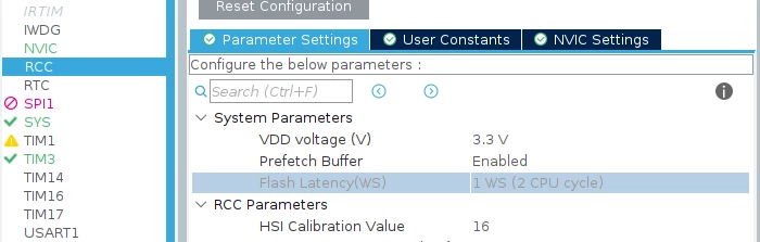

December 5, 2023
using cube, it should set flash wait correct, see ->
and about alignment : you have to set it...if needed

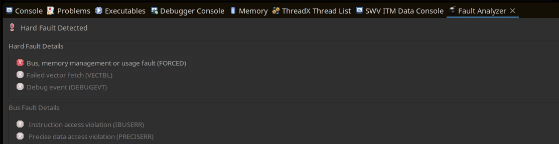

++ in ide: on debug (menu: window-> show view -> fault analyzer )  might help, after a hard fault, to see..
December 5, 2023
What are your clock settings? Flash wait states is typically configured in SystemClock_Config. If you have insufficient wait states, you can get memory errors everywhere like this. Since it's both in the stack and heap, could be what you have going on here. Unlikely to be a buffer overflow on the stack, as that wouldn't go into the heap.

December 13, 2023
I configured the 'Flash wait states', with the call:
HAL_RCC_ClockConfig(&RCC_ClkInitStruct, FLASH_LATENCY_2);
and it's "Two wait states"... and it's already the highest value.
Anyway, I'll give you the rest of the clock initialization.
if you have any ideas...
Thanks
andrea
