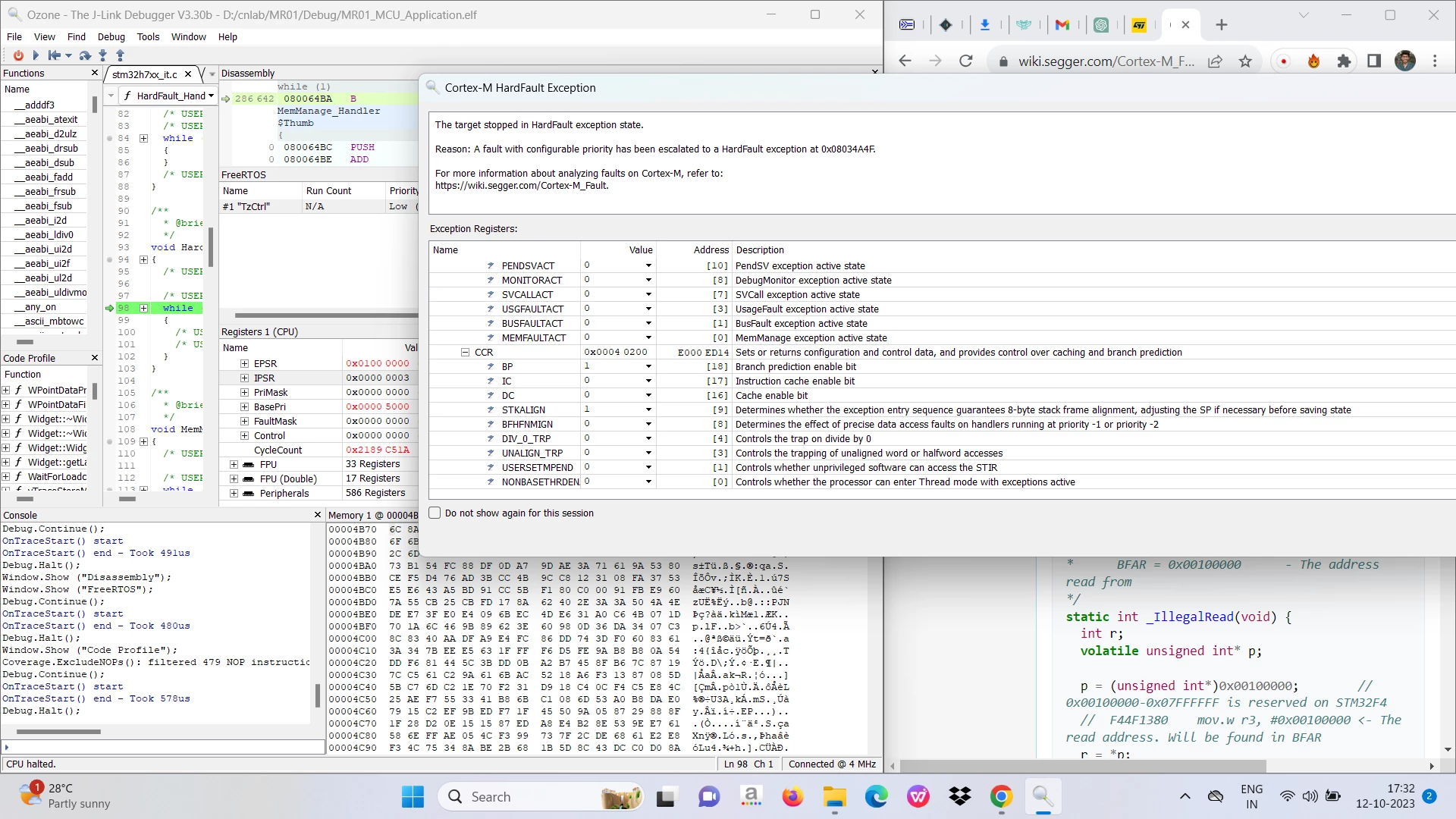

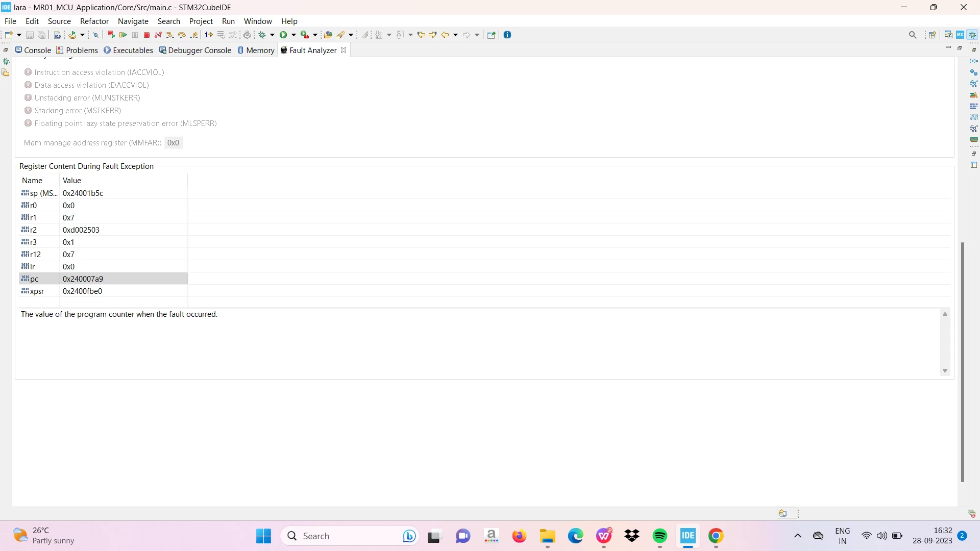

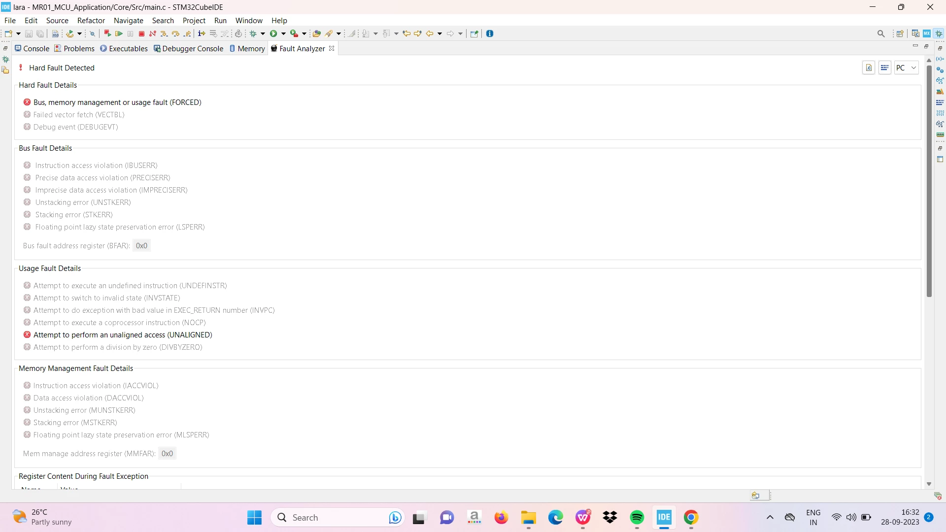

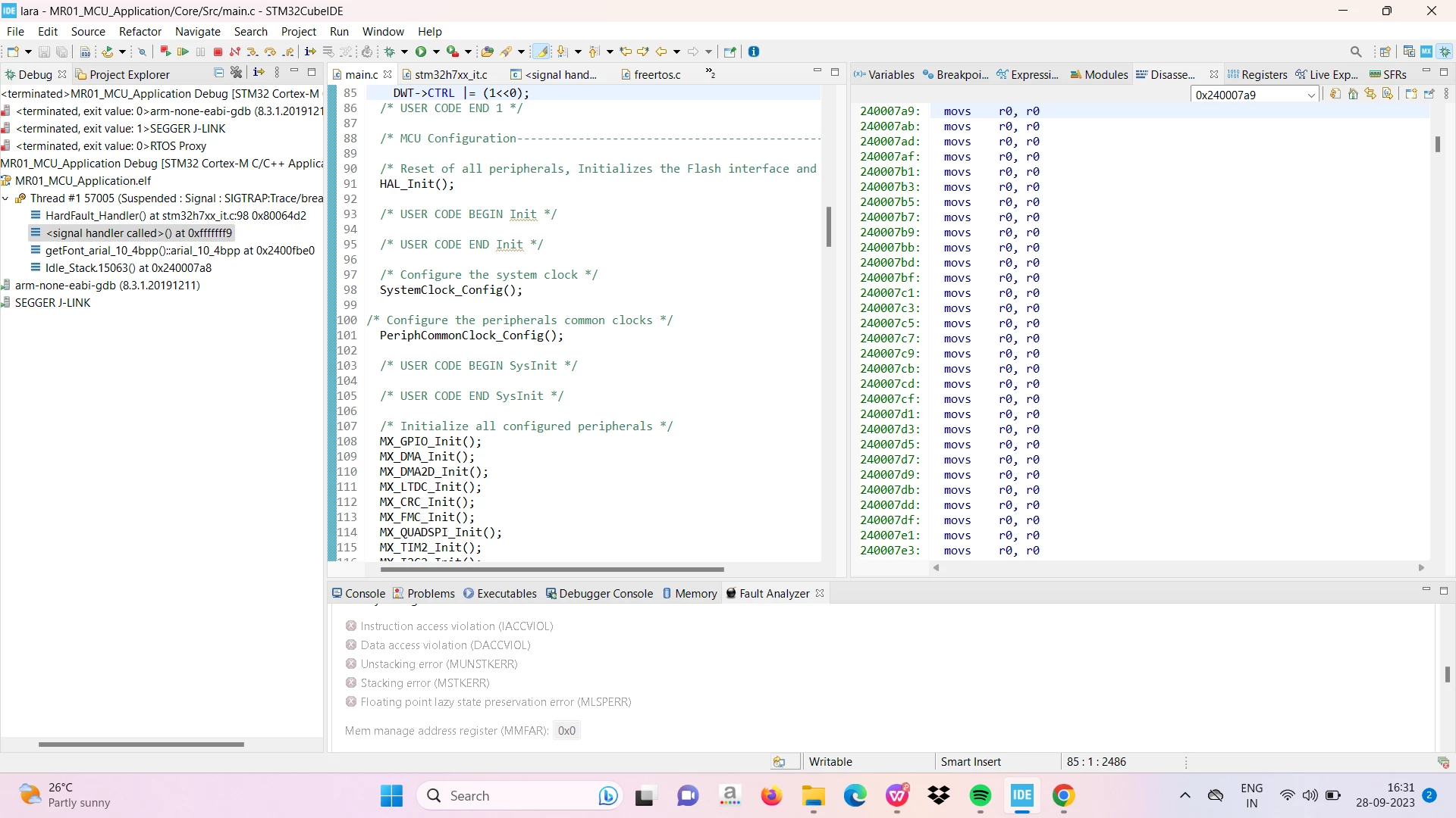

The SystemView is running properly when I don't integrate TouchGFX into STM32CubeIDE. However, when I integrate TouchGFX into my code, I'm able to debug with ST-Link. On the other hand, when I use J-Link, I'm getting a hardfault error while debugging. Below, I have attached screenshot .i will send the detailed problem if someone is willing to help me regarding this.

Which product do you use? Toolchain/version? Do you see the same behavior without RTOS? Can you step by step in debug and check in the code the memory accesses that are not aligned to the data size being accessed?

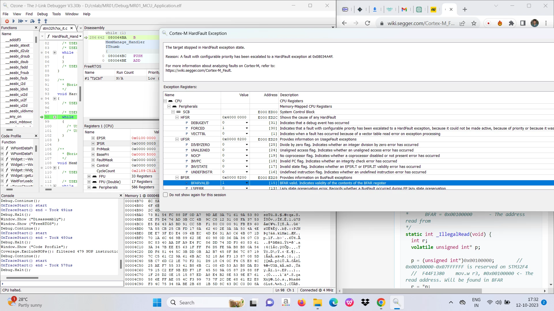

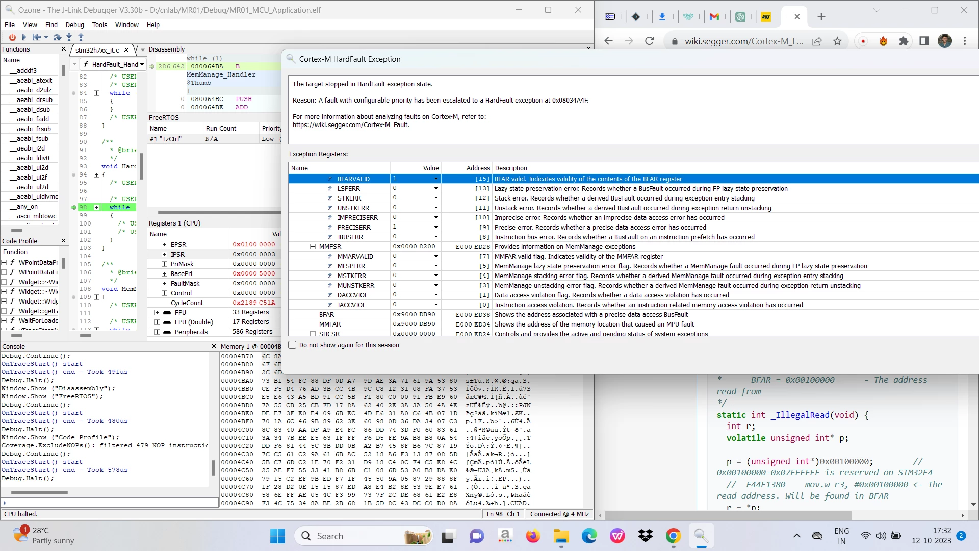

The problem for us is debugging through Segger J Trace Pro along with touchgfx enabled is leading to hard fault error since we do not have any information to map the screen data to external flash throught QSPI when we are using Segger J Trace Pro.Below i have attached the screenshot of  faults i'm getting when i debug through ozone.

Look at what's actually faulting. The code and the registers to provide context.
Seems to be an unaligned read? Not clear what MCU you're using.
With System Bring-Up I strongly recommend getting a UART and printf() working, and you have a Hard Fault and Error Handler that output actionable data so you can identify what's going wrong quickly.

Faulting on the read of QSPI at 0x9000DB90, I would perhaps dump out the QSPI peripheral context, and insure it is in Memory Mapped mode. Are you changing modes of the QSPI and sending direct commands? The debugger is not interacting with the memory device?
Double check MPU_Config settings for QSPI region
Instrument HardFault Handler properly so you can observed failure outside of the debugger. while(1) loops just fail in darkness..
