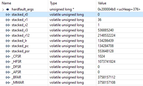

Some time ago, I was getting a Hardfault in a STM32F103 baremetal firmware. Even posted the question here, but I wasnt able to fix it. So, I moved to FreeRTOS-CMSIS, not to get rid of the problem, I was moving anyway. I'm still with this issue.
I think it is related to printing some floating point numbers.
I checked "Use float with printf from newlib-nano (-u _print_float)" in the project.
One task prints to a UART (redirection using _write()) the float values of GForce in 3 axis every 10ms.
printf("%5.2f, %5.2f, %5.2f\r\n", accScaled[0], accScaled[1], accScaled[2]);

It doesnt seem to be a Stack overflow, since it runs for several seconds (minutes sometimes) and uxTaskGetStackHighWaterMark() returns 90 words left of stack on the task.
Started debugging the Hardfault using this commit.

The disassembly point to this code (instruction 0x080105a2):
__i2b:
08010594: push {r4, lr}
08010596: mov r4, r1
08010598: movs r1, #1
0801059a: bl 0x8010370 <_Balloc>
0801059e: movs r2, #1
080105a0: str r4, [r0, #20]
080105a2: str r2, [r0, #16]
080105a4: pop {r4, pc}
I know I could stop printing floating point numbers and the fault would probably stop. But is very handy for debugging purposes. It should work fine.
Right now, I'm stuck on this. Can anyone give me a hand?
Let me know if is any info I could post to better expose the problem.

One thing that immediately catched my eye:
The malloc() functions take memory from the heap, not the stack.
But many IDEs set the default heap size to zero when creating a new project. Or, your heap could overflow.

But what do the SCB registers say about the hardfault reason ?
Perhaps a propagated fault, because of a missing handler ?

My thoughts about this, so far:
I got it working with two solutions, by working I mean that the firmware didnt crash running for some minutes (need more time of testing for a definitive response):
  1. Original faulty firmware (crashing within 1min of operation on the accelerometer example I described) with just removing the sysmem.c file (the one with _sbrk()). Why it works without the _sbrk definition? No idea! I couldnt find _sbrk definition anywhere else. It shouldnt even compile (who calls this after all?). Anyway, this way it works using DMA for UART transmission and its more practical, because I can use the code generated by Cube as is.
  2. Using Nadler's solution.
What I did:
  • changed heap management for the one provided in his post. (thanks Nadler!);
  • Removed sysmem.c (because now it was a duplicated definition of _sbrk());
  • Defined #define configUSE_NEWLIB_REENTRANT 1
  • Had to stop using DMA to transmit data on the UART (redirection using _write()). Despite being called with the right parameters, the _write() function was getting stuck in the second call, where I check for UART state (was busy forever).

I had the same problem, which kept me baffled for a very long time.
I just doubled the "Stack Size(Words)" from "128" to "256" from RTOS -> "Tasks and Queues" and my problem was solved.
