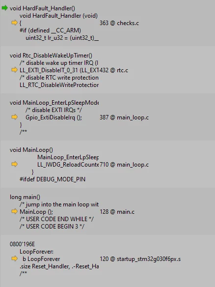

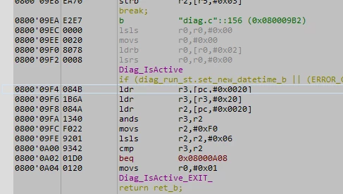

Now, I have show what is at this address for a function with the dissassamble:
But the callstack from the MCU show me a other address:
I dosn't understand it at the moment, why is a 32bit ASM command is broken inside.
I use for the main loop only RAM functions, to becomes the needed performance. But the function Diag_IsActive() is placed into the flash. If this a problem?

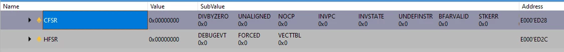

The status register CFSR and HFSR are cleared by the entry of the hardfault exception handle:
LR = 0xFFFF FFF9 (use MSP)
SP = MSP 0x2000 1E18
R0 = 0x2000 1E18
R1 = 0x4000 2800
R2 = 0xFFFF FFF9
R3 = 0x2000 1E18
R12 (IP) = 0x2000 1E50
R14 (LR) = 0xFFFF FFF9
R15 (PC) = 0x2000 1C08
xPSR = 0x0000 000F
What I see is, that R15 (PC) points to the start of a global variable and R12 (IP) points into the stack. The xternal trigger is the change of a digital input and configuration the GPA2 to LSCO output.
But this exception is not every time triggered.
The bus fault, alignment fault and so can removed, the CFSR and HFSR are 0 by every hardfauld exception.
Have every one a idee where can come this problem?
