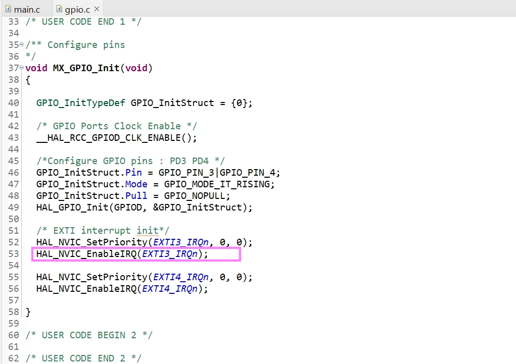

HAL_NVIC_EnableIRQ() not generated with checkbox enabled for EXTI
The call to
HAL_NVIC_EnableIRQ(EXTI3_IRQn);
is not generated with the checkbox enabled in the GPIO/NVIC panel in gpio.c
However:
the call for HAL_NVIC_SetPriority() is generated correctly.
MCU: STM32L496ZGTx
STM32CubeIDE: Version: 1.17.0
pads: PD3, PD4 set up as EXTI, NVIC enabled for both.
generated code: (section of gpio.c):
/* EXTI interrupt init*/
HAL_NVIC_SetPriority(EXTI3_IRQn, 0, 0);
HAL_NVIC_SetPriority(EXTI4_IRQn, 0, 0);
HAL_NVIC_EnableIRQ(EXTI4_IRQn);
is missing.
Jun 11, 2026 9:23 AM UTC
Hello ​@Adriano Melis
I reproduced the behavior and the HAL_NVIC_EnableIRQ(EXTI3_IRQn); was generated on gpio.c file.
I recommend that you use the latest STM32CubeMX Version 6.17.
I will be waiting for your feedback.
Thanks.
