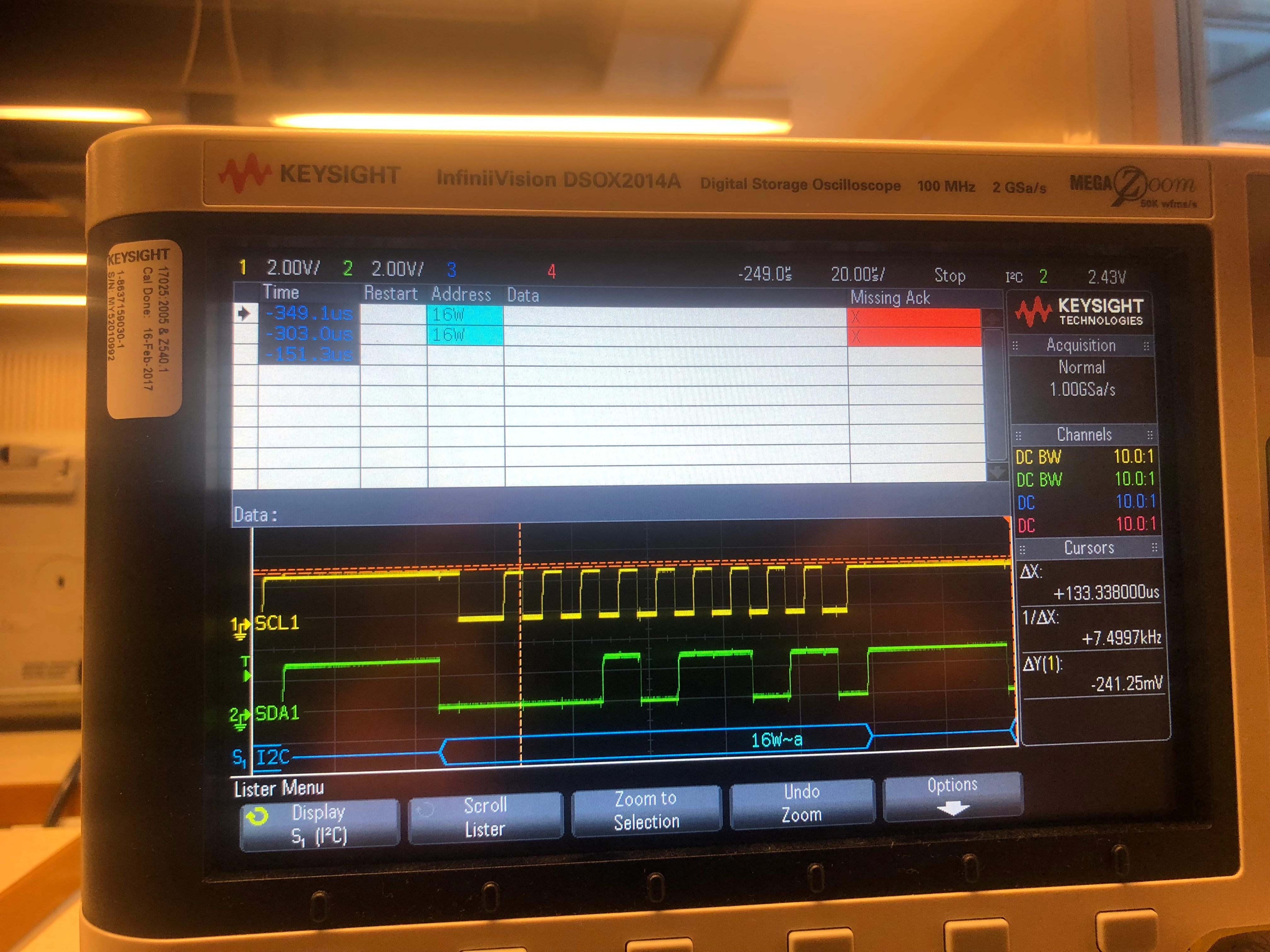

And I also tried to decode it using ossilscop:

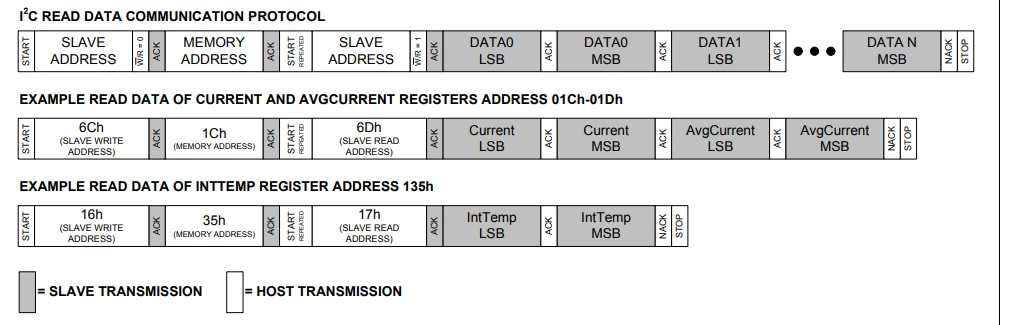

    Cause it's WRITING the memory/register address FIRST...
    ret = HAL_I2C_Mem_Read(&hi2c1, dev_address, 0x121, 2, tempData, 2, HAL_MAX_DELAY);
    The SLAVE address is not 0x16 or 0x6C, and the REGISTER address is 8-bit wide.. Would strongly suggest reading some data sheets.. It's not responding because you're addressing it entirely incorrectly.

    Ok, cite your sources.. You're clearly looking a different documentation than I am.
    Diagram how you have the parts wired up, it will impact the SLAVE ADDRESS. The default strapping presumably dev_address = 0x90; You are using a MAX30205 right? Not something else? If the address is wrong the slave won't ACK, it's how you determine a part is present and responding.
    The Memory address is 8-bits wide (1-Byte), not 16-bit (2-Byte)
    Surely the rational interpretation for the example diagram (2nd line) would be
    uint8_t tempData[4]; // 4 consecutive bytes read
    ret = HAL_I2C_Mem_Read(&hi2c1, dev_address, 0x1C, 1, tempData, sizeof(tempData), HAL_MAX_DELAY);
