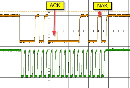

I have a problem, when an I2C_MEM_READ_IT encounters a NAK on the memory address.
A typical I2C mem read is:
Start DevAdr(W) (Ack) MemoryAdr (Ack) RepeatedStart DevAdr(R) data(A), data(A)... data(N) Stop
If during this transaction, the first DevAdr(W) is Acknowledged, but the Memoryaddress is NACK, the transaction should stop there and does not need to continue trying repeated start etc.

The memory address is sent out (8bit memory address) and the code is waiting for the TC flag being set (Transmit complete)
If there is a NAK, TC never gets set, instead NAKF is set. But this code does not check for the NAK flag.
There is is a timeout, which triggers, but the I2c_Mem_Read is exited with the hardware in a bad state.
When a next I2C_MEM_read is started, it failes here:
static HAL_StatusTypeDef I2C_RequestMemoryRead(I2C_HandleTypeDef *hi2c, uint16_t DevAddress,
uint16_t MemAddress, uint16_t MemAddSize, uint32_t Timeout,
uint32_t Tickstart)
I2C_TransferConfig(hi2c, DevAddress, (uint8_t)MemAddSize, I2C_SOFTEND_MODE, I2C_GENERATE_START_WRITE);
/* Wait until TXIS flag is set */
if (I2C_WaitOnTXISFlagUntilTimeout(hi2c, Timeout, Tickstart) != HAL_OK)
return HAL_ERROR;
The TXIS flag stays zero. The transaction stops immediately after transmitting the device address.
The bus is blocked, clock stays low and the bus is stuck.

    I attached the code. It is a very basic CubeIDE project which uses I2C3. It has a very simple loop in main.c which tries to do a mem read on 0x14 adr 0x12 every 500ms
    The i2c blocks after two attempts.
    First read attempt: Deviceaddress is ACKed, Sub-address is "NAKed"
    I try to talk to a LTC1760 which rejects a subaddress, if it is not available.
    This transaciton ends "normal".
    Now, If I try to repeat that, the result is:
    Not the bus is stuck. Clock is stuck low (STM32 holds it low) the I2c Hardware shows the "busy flag".
    See attached project (STM32G474RET6)
    The Bus can be reset by clearing the PE bit in CR1, waiting a few cycles and setting it again
