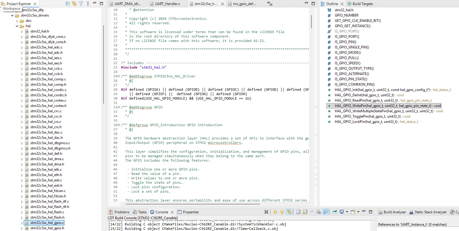

For instance, stm32c5xx_hal_gpio.c HAL driver, it's all grayed out. The right column shows all the functions have a slash.

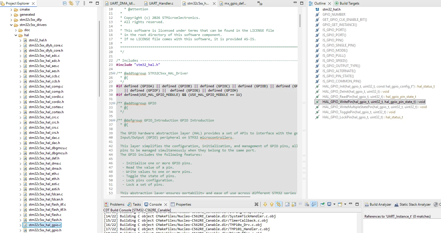

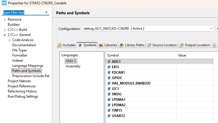

When I add "GPIOC" which is a one of the symbols, it enables the whole file. I have to add symbols for other peripherals as well.
You can see it's not grayed out and in the right column, the slashes are gone.
Now I am able to type a few characters and hit CTRL + Space to bring up a list of available functions.

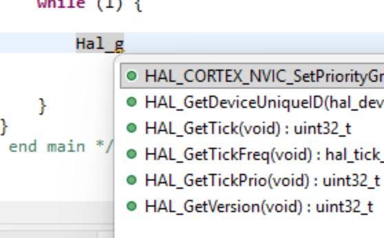

Autocomplete is clearly working in your screenshot.
What function are you looking for?
Apr 9, 2026 1:09 PM UTC
HAL_GPIO_ReadPin for example.

​@Karl Yamashita I have a better and simpler solution for you… you just need to define the symbol for the specific chip flavor you’re using.

I have my project set up for an STMC32552VET6.  So I put STM32C552xx into C/C++ General / Paths and Symbols / Symbols, and voila, the IDE recognizes the HAL code now.  This works because this is the sole symbol that is being emitted to the code build from CMake.  In flags.cmake I find:
  target_compile_definitions(${CMAKE_PROJECT_NAME} PUBLIC STM32C552xx _RTE_)
Just for giggles and completeness, I added _RTE_ to the symbols as well.  It would be helpful if ST would set the MCU symbol in the CubeIDE project when importing the CMake project.
