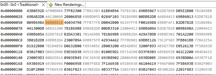

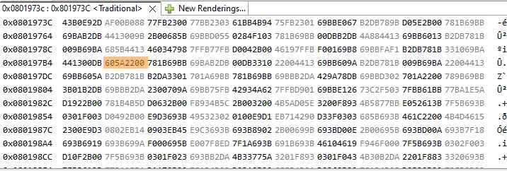

Feb 11, 2025 1:32 PM UTC
some additional info: it looks like the copy function is working.
This is the content of the Flash
Code in FlashCode in Flash
and this is the content of the ITCM-RAM after startup:
ITCM-RAMITCM-RAM
a visual comparison tells me the contents are almost identical, except one word (3rd line) which i marked red.
In the Build Analyzer it looks like it should look like - according to the tutorial @ahsrabrifat linked in his post, with sections for the .itcmram in "FLASH" as well as "ITCMRAM"
When I remove the code to copy the memory contents and restart the Nucleo (remove power, wait 30) seconds, the memory contents look different ...
