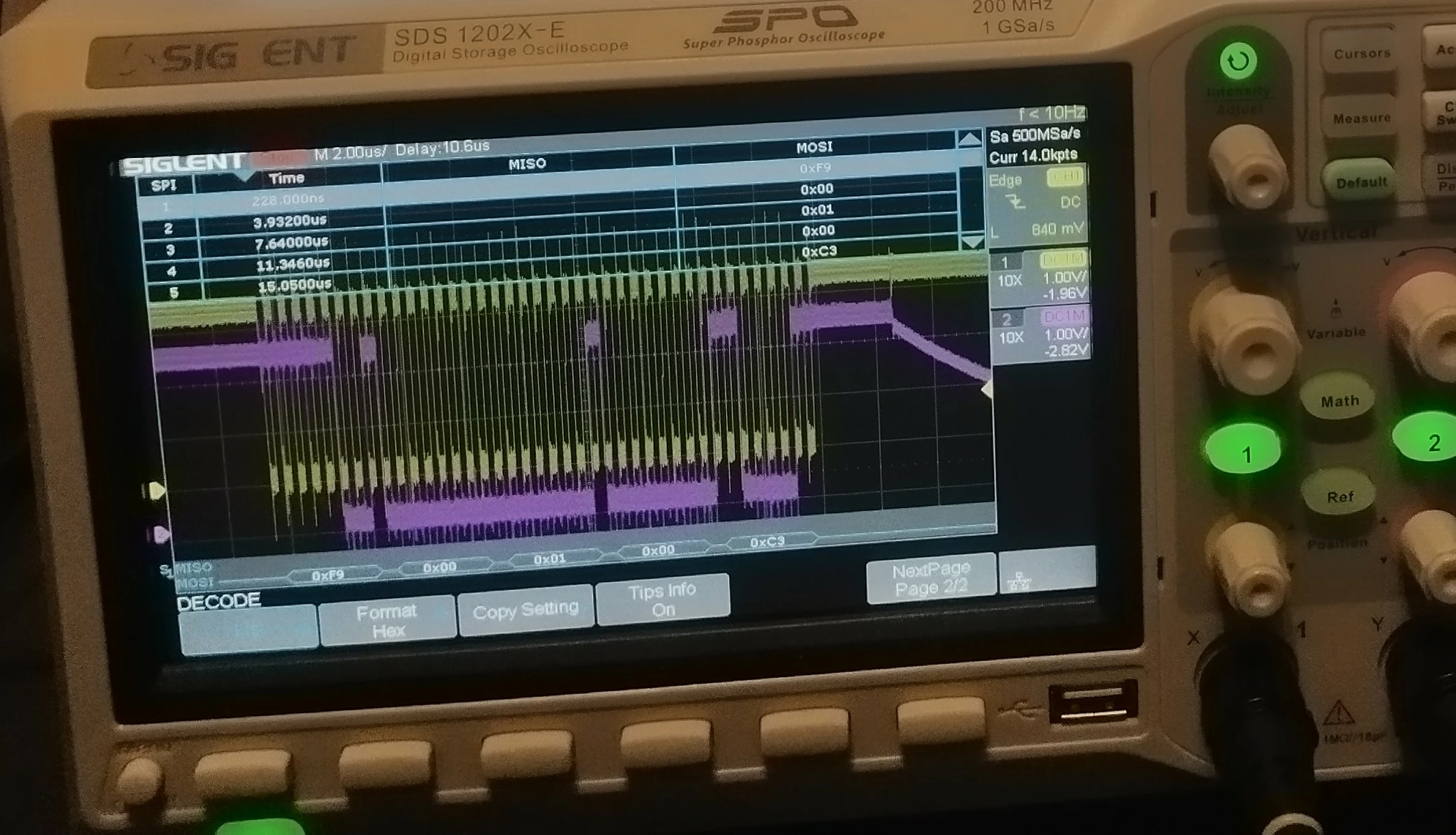

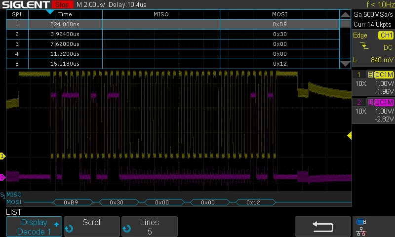

Hi! Do we have write acces on pin set to alternate function push-pull?
Problem: CLK line floats after hal_transmitreceive, pullup helps but distorts clk line.
And with pullup there seems to be a glitch at end that slave can detect as fake clock cycle and push MSB out of its scope and add to end radom bit.
Should i go with LL spi will this help?
Attachment: clk with pull-up, yellow - clk

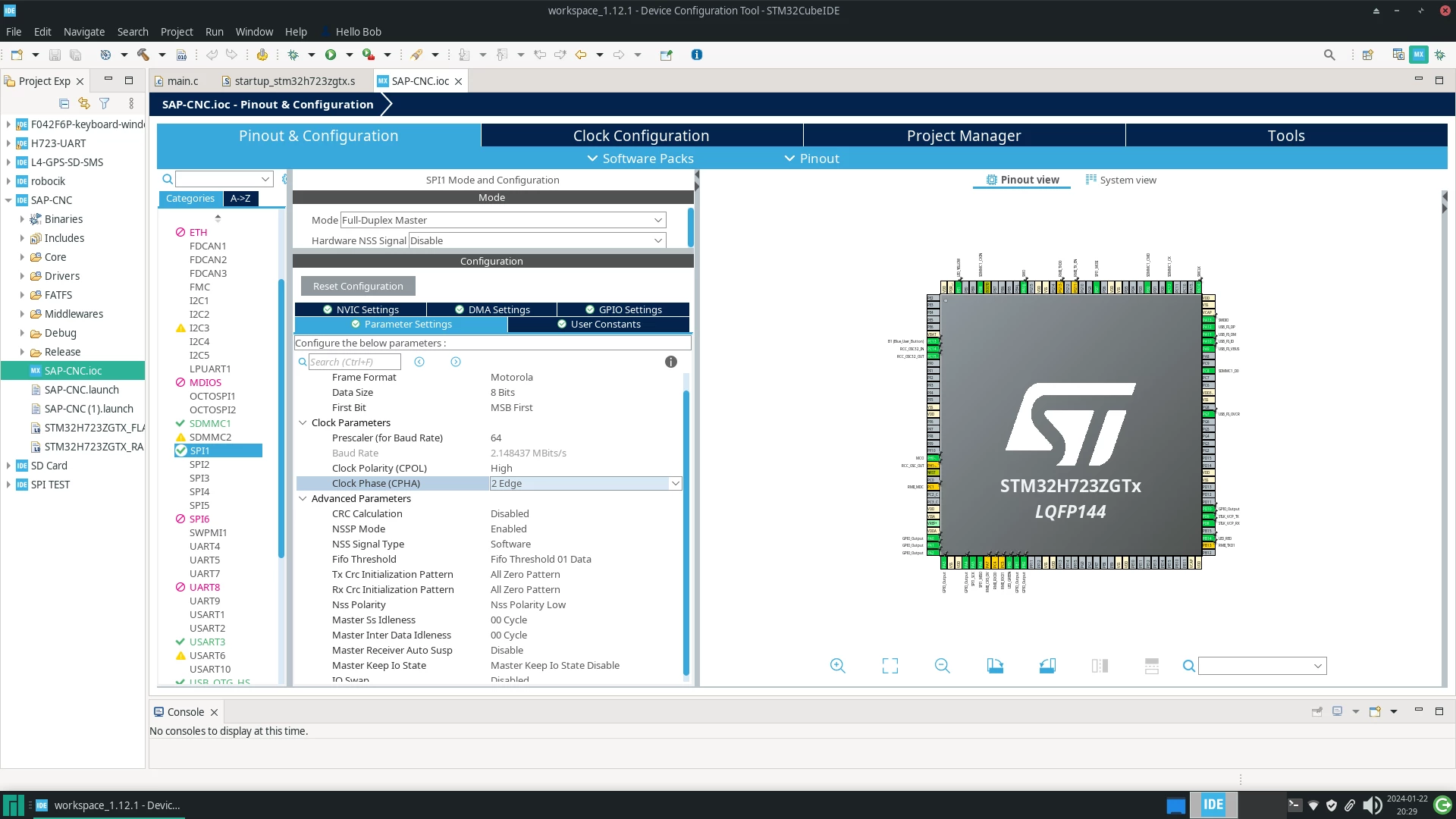

    Its STM32H723ZG
    How to disable releasing the pins?
    Master keep io state : enable ?
    Or should I set AFCNTR in SPI_CFG2 (bit 31) "LL_SPI_EnableGPIOControl" in the LL library?

    January 22, 2024
    Yes exactly. Enable Master Keep IO state.

    This setting solved the problem.
