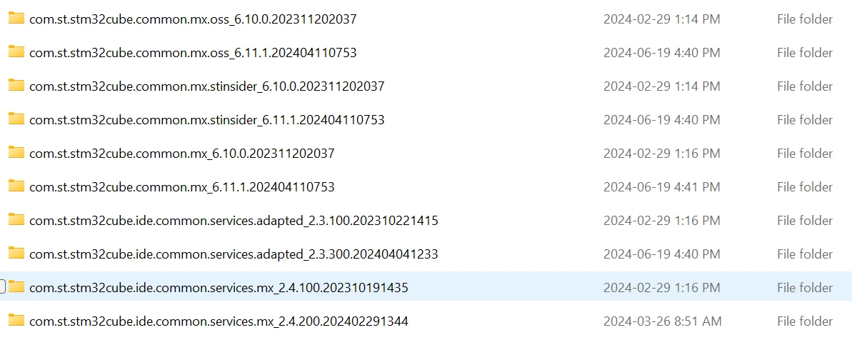

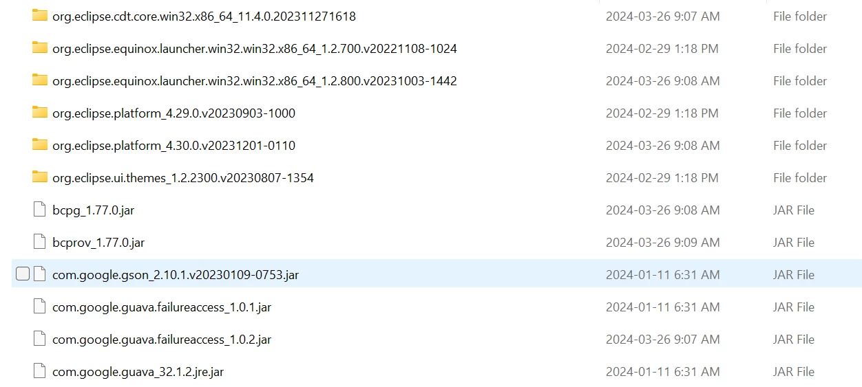

The plugins folder at C:\ST\STM32CubeIDE_1.14.1\STM32CubeIDE\plugins is 5.24 GB. It has lots of com... folders, lots of org... folders and lots of .jar files. Some of the folders are referenced among my STM32CubeIDE project Includes, even though the paths to the folders are not present among my compiler include paths.
What are all these folders and files for? Can I get rid of any? The folder is so huge. Why are they in my project anyway? Thank you for your help!

You have alot of duplicates with differnt versions. Looks like you (or the IDE) installed a newer version into an existing folder. So you could get rid of about half the folders be a clean install. Otherwise, I wouldn't mess with those folders. Some plugins are used for STM32CubeIDE which itself is built upon Eclipse.

Indeed I started looking for bloat because my 256 GB is up :)! Recently my STM32CubeIDE 1.14 upgraded to 1.15 so perhaps that's the cause of duplications. I like the idea of a clean install in the next round. Thanks to all of you for your insights! Most appreciated.
