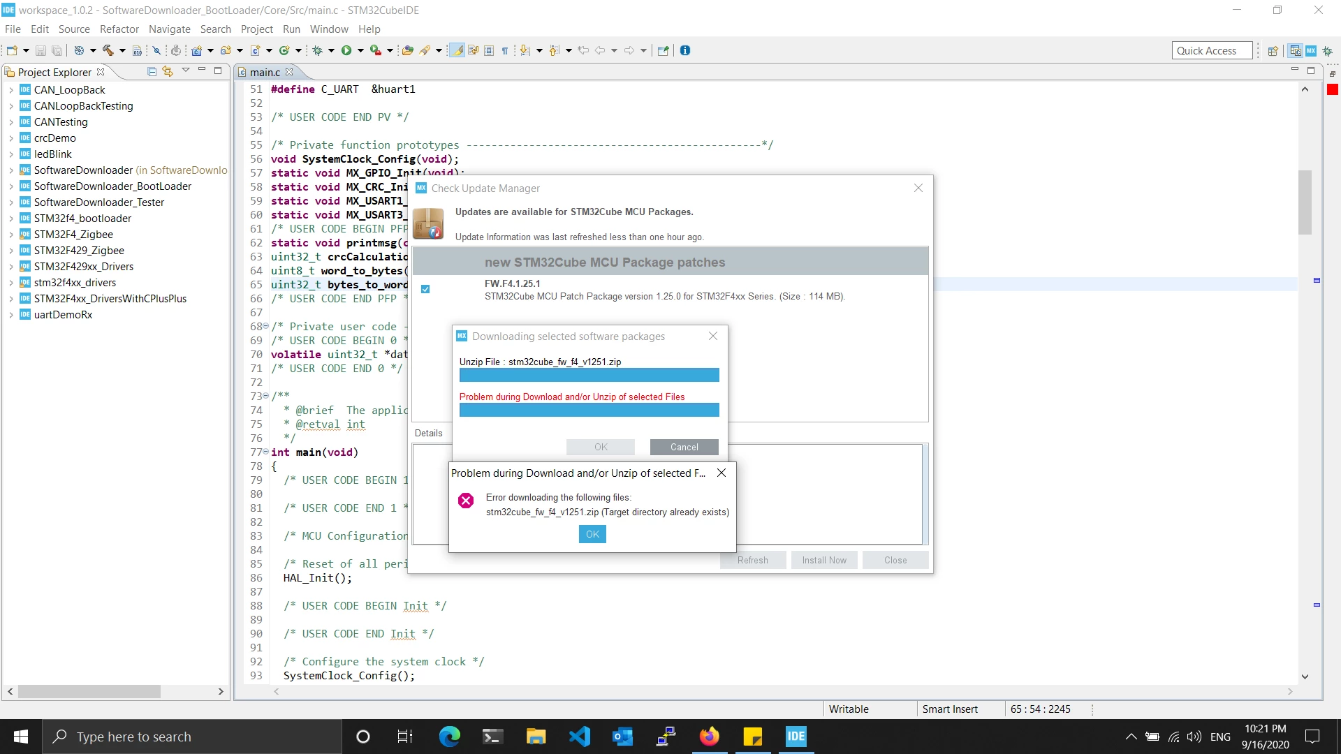

Perhaps close down other instances that have the directory open.
The "Patch" is going to be applied to the existing v1.25 F4 Repository branch.
RDube.1
RDube.1Author
September 16, 2020
That is the problem​ whenever it trying to patch, its giving this error. We are a team of six members and everyone facing same issue.but it successfully patched in linux system so i copied repository dir to windows and working fine.may be some problem with windows patch system.
