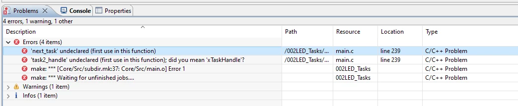

I am working on a project where I am using FreeRTOS. It was working fine but after adding a couple of more features there are strange errors.
It says that the particular variable doesn't exist but the variable is actually initialized in the same code/file.
Please help
Thanks
Rahul
see the code below: the error is

int main(void)
  /* USER CODE BEGIN 1 */
  TaskHandle_t task1_handle;
  TaskHandle_t task2_handle;
  TaskHandle_t task3_handle;
  TaskHandle_t  next_task;
  TaskHandle_t button_handle;
  BaseType_t status;

void LEDHandler1(void* param)
BaseType_t status;
extern TaskHandle_t next_task;
extern TaskHandle_t task2_handle;

Hello @rahulrajsharma123 ,
Maybe the issue is with your project configuration and you're missing some include files defining the functions.​
You'd want to review the defines and include paths used.
Imen
Bob S
October 2, 2023
int main(void)
 // more code that doesn't matter.....
You declare these ^^^^ variables as LOCAL to main().  There is no way to access them from other functions, not even with "extern" declarations.  Move these declarations outside main() to make them global variables.  Then remove the "extern" declarations in the other functions (not needed as long as those functions are in the same source file as the declarations).
