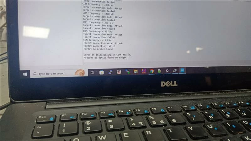

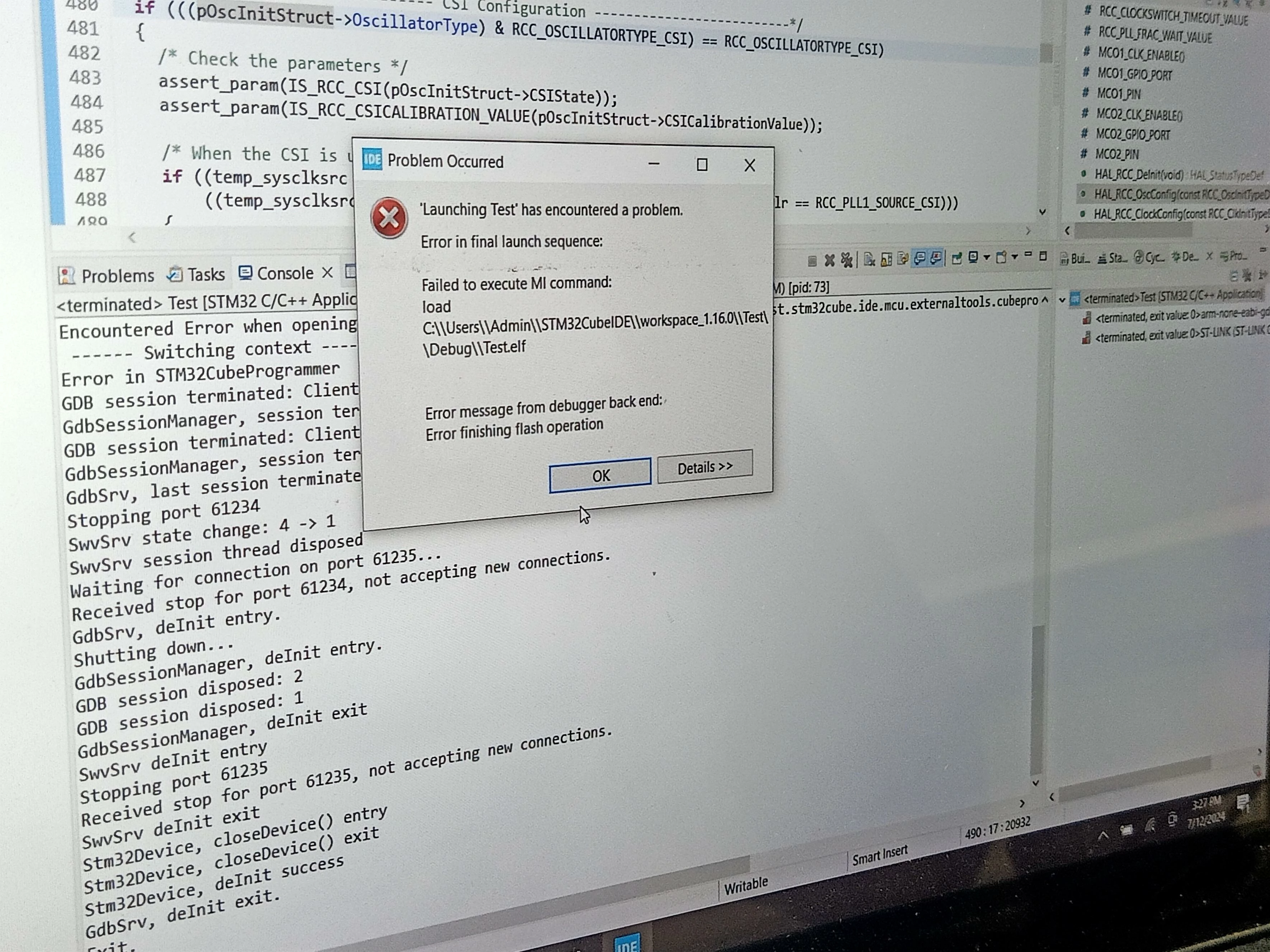

      We are currently using NUCLEO-H503RB (NUH503RB$MR1) Eval board. We are using STM32 Cube IDE for flashing the board. Upon connecting the Eval board with USB-C cable it get detected by the IDE. But during flashing we are getting the following errors which I have attached below. Even if we flashing a empty project we are getting the same error. Kindly give some solutions for this issue as soon as possible.
Thank you.

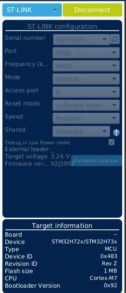

download/install CubeProgrammer ; then connect to target: show, what it tells...
(to find out: can connect etc. )
like here:
