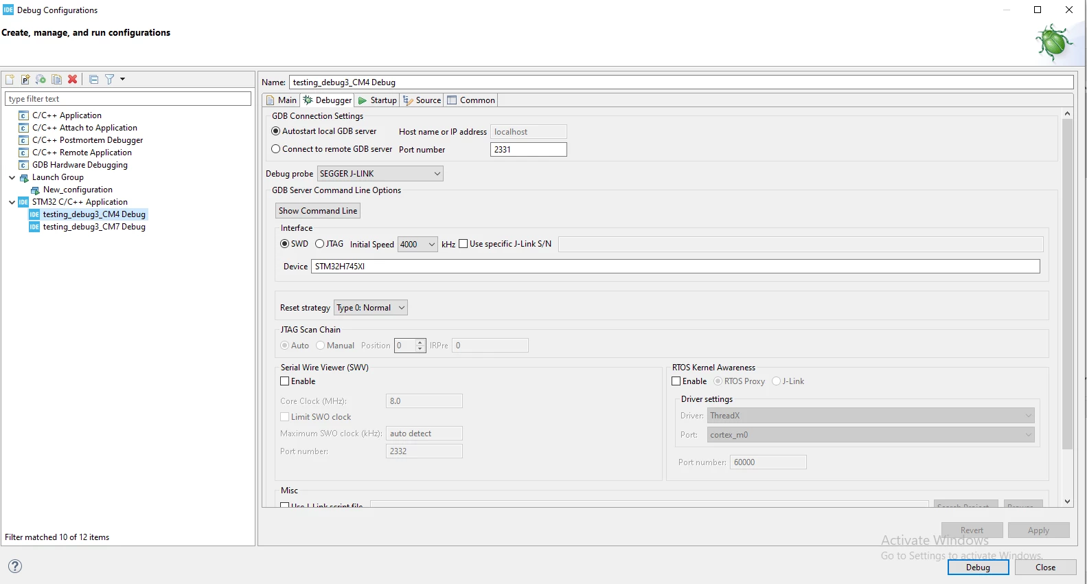

I am using SWD mode in Segger J-link for debugging. I am getting error "Could not verify ST device" when I am trying to debug CM4 core and debugger don't enter the CM4 core but CM7 is working fine. I am using CN16 TAG connector on discovery board for programming. I also tried creating a launch group, in that case also I was getting the same error. How to solve this issue?

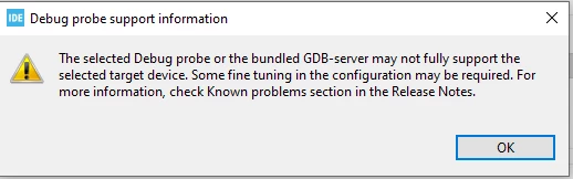

Further when I change the debug probe from ST-Link GDB server to Segger J-link in debug configuration, I get a warning saying that some fine tuning would be required for Segger J-link to support the target device. What fine tuning is required for it to support the target device?

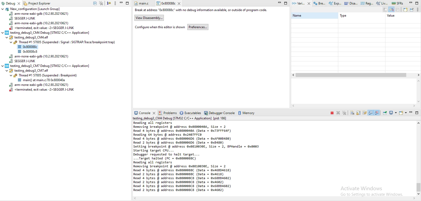

Hi @F.Belaid​  I followed all the steps but it did not help. Sometimes the error "Could not verity ST device" come and sometimes the M4 core gets stuck in another error "break at address 0x... with no debug information ..."
Image attached showing error

When debugging dual-core devices you need to tell the debugger which core to connect to. With SEGGER I believe that the access ports managing the communication to the different cores are hidden behind "device names". So, to communicate with the M7 core, you have to specify the :
STM32H745XI_M7
For the Cortex-M4 core the device name should consequently be set to:
STM32H745XI_M4
Does it help?
