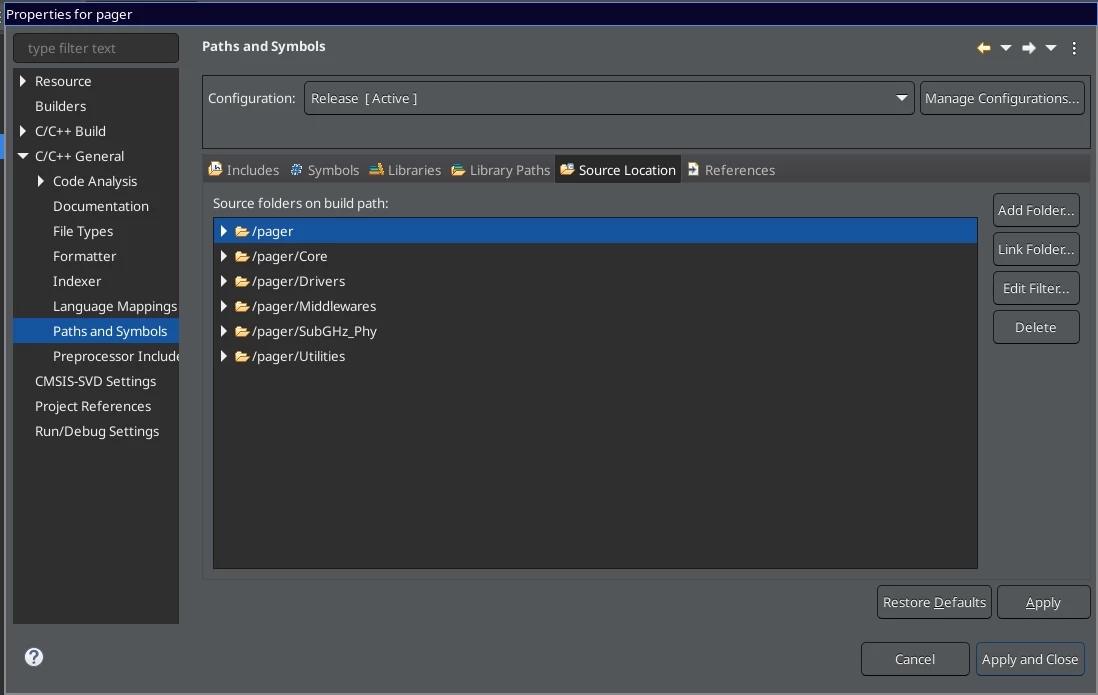

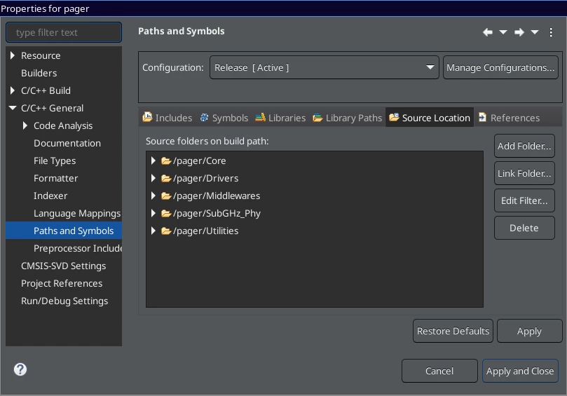

Okay... able to reliably reproduce this every time.  I didn't do anything other than generate.  It may be an issue with using the root project folder as a "Source Location"
BEFORE:
AFTER:

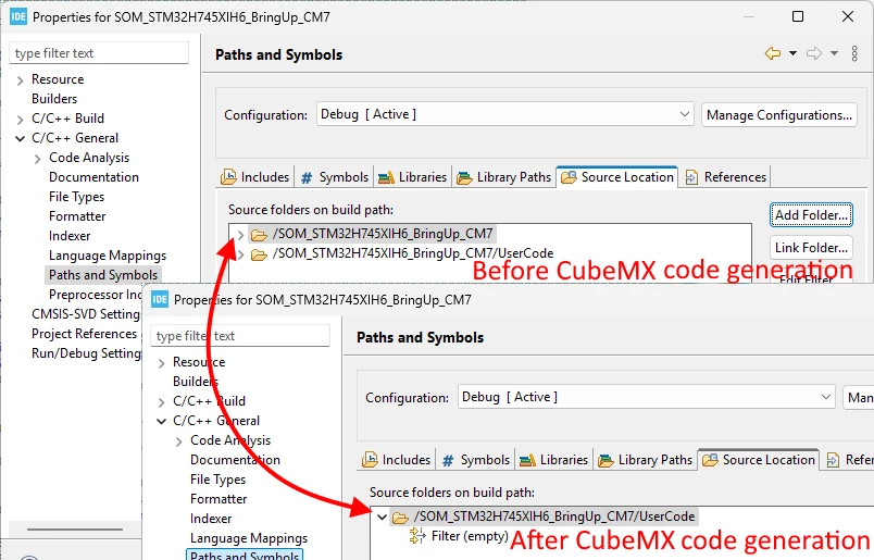

I am experiencing the same problem, did you find a solution ?
It deletes the first line whenever I generate code with CubeMX.
