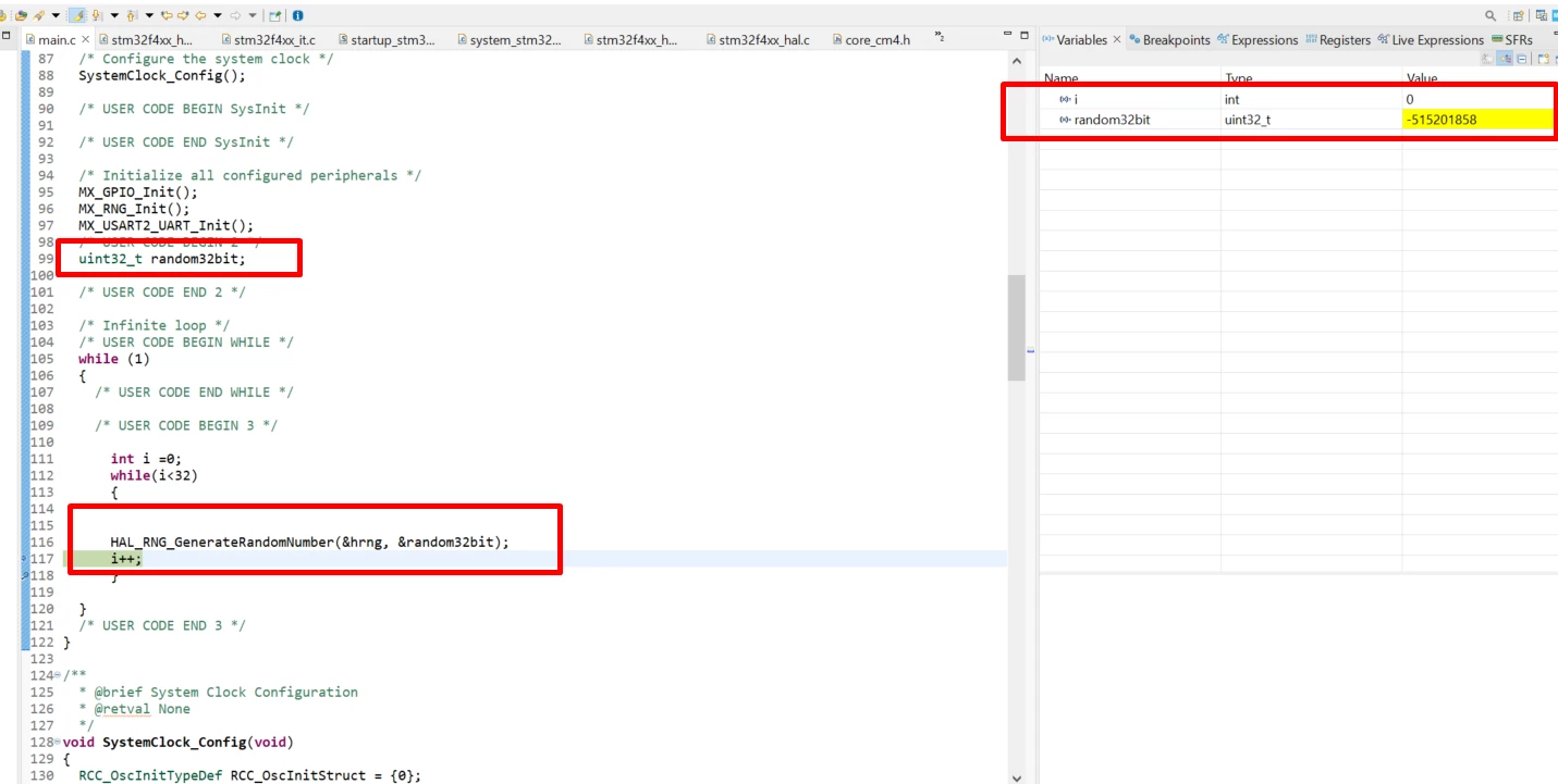

Generated random number is negative, but I expect it to be positive
I am using HAL_RNG_GenerateRandomNumber API to generate random number between 0 to  4294967295, but when I debug the code, I see that the random number takes negative number.
Could anyone please help me with this?
Thanks.
1 reply
February 4, 2024
Just an IDE bug. You can ignore it, or right click and view it as hex or something else.
