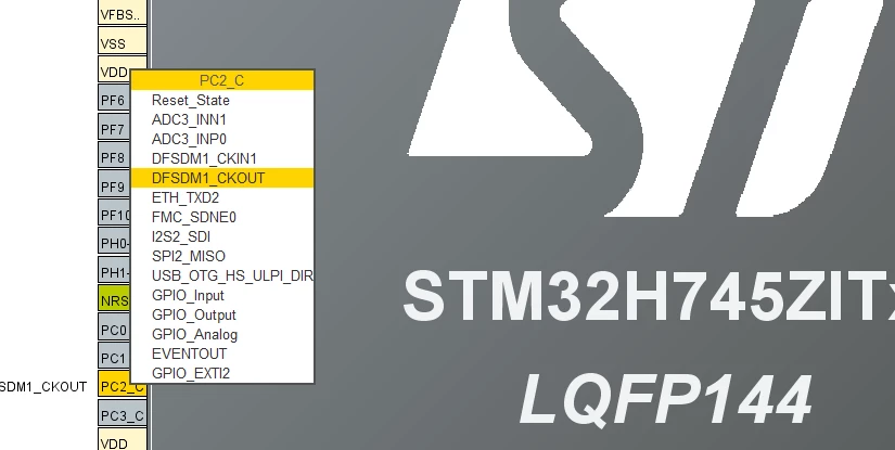

@ABlum.2​ That pin has the DFSDM1_CKOUT option.0693W00000BaXMaQAN.pngI never used this peripheral but its meant for driving external ADCs so the DFSDM1_CKOUT pin can generate a very fast pwm clock signal for you.
Did you tried this already?

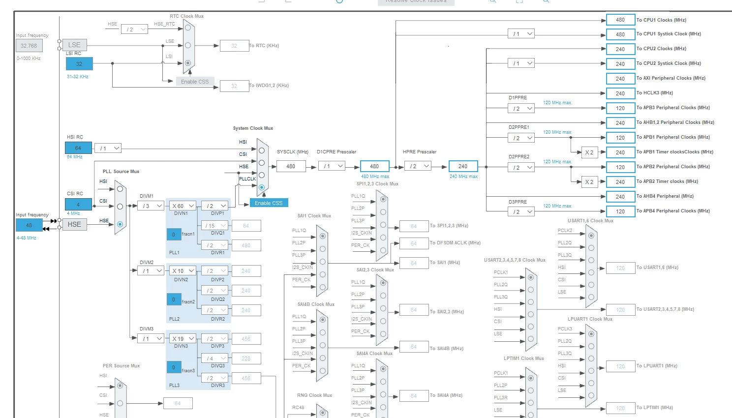

Are you using a XTAL as a HSEclock source?
How high is your system clock?
Maybe share a snap of your cubeMX page clock setup
hit me up in https://www.linkedin.com/in/javiermuñoz/
ABlum.2
ABlum.2Author
Jun 9, 2021 10:05 AM UTC
0693W00000BaVWsQAN.pngHi Javier,
Thanks for the answer here I send you a picture of the clock setup.

Javier1
Javier1Best answer
Principal
Jun 9, 2021 2:26 PM UTC
