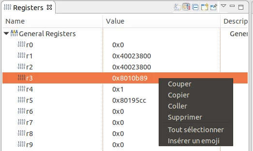

Is-it possible during a debug session to modify general registers (e.g r3 ) .
Context: Win 7 host with Virtual Box 6.0.4 for client Ubuntu 18.04 running STM32CubeIDE 1.2.0 on the integrated debugger of the Nucleo demoboard with STM32F412ZG
Help Center tells:
"In the Registers view, right-click a register and click Change Register Value."
but the screenshot below ( french version ) shows cut/copy/paste/delete/select all/ and the last but not the least "Insert an Emoji" ! ( after right click around the register value)

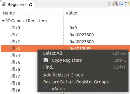

0690X00000BwGzAQAV.pngAfter a right click on the register name r3 I have a english menu this time !
Modification through "Watch" is also not possible.
Colleagues told me it was possible with Attolic to modify general registers during debug.
Many thanks in advance for any hints

Indeed it works but you have to make a "Paste" with the modified value. It is not very convenient...
