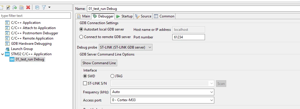

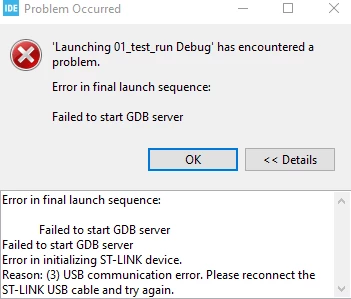

After updating to STM32CubeIDE 1.14, I can't program my custom boards or Nucleos. I have tested three Nucleos.
  • Debug probe STL-LINK GDB server -> fails. All custom boards and Nucleos give me the same error, as seen in the image below.
  • Debug probe OpenOCD -> works fine on all boards and Nucleos.

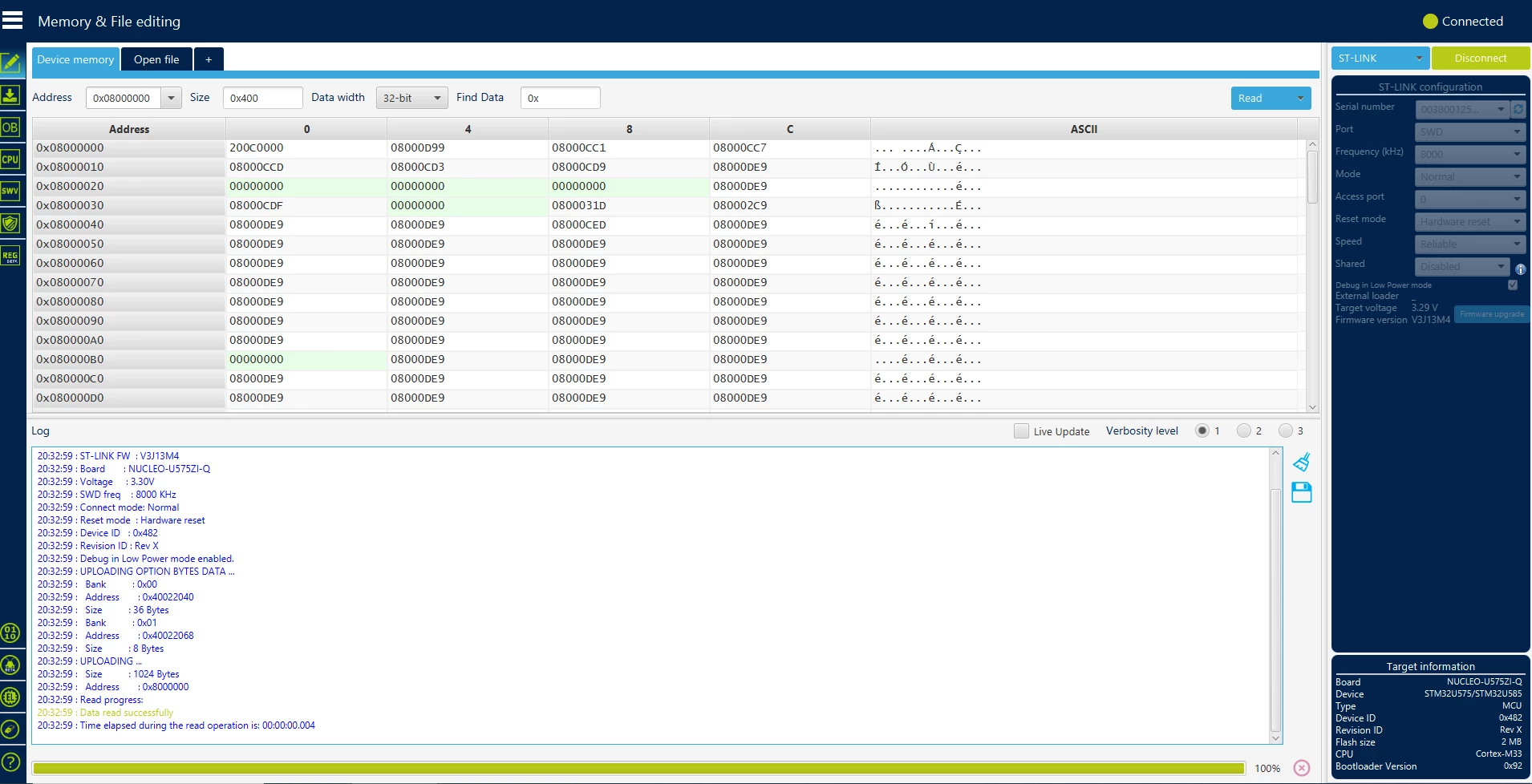

  • STM32CubeProgrammer works fine.
I have reinstalled all programs a couple of times, but I keep getting the same error.
Any ideas?

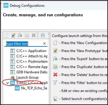

    Pavel A.
    March 16, 2024
    Try to create new debug configuration for STL-LINK GDB server, rather than reusing configurations created before update.

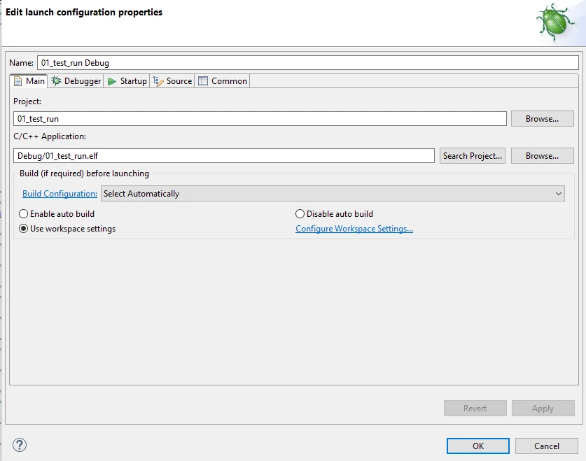

    By the way, I tried:
    • To use different reset modes, software, hardware...
    • Erase the UCs with the STM32CubeProgrammer, erase is off but keep getting the same error.
    • Update the firmware, the last version is successfully flashed but keep getting the same error.
    • Delete the .elf file to create new debug/run configuration.

    Hi Pavel
    I deleted the .elf file, a new one is created when start a new debug/run sesions, it is Ok or I should try something else? After that problem persist.
    Daniel H Sagarra
    Pavel A.
    March 17, 2024
    @dhs Not the .elf file. Create a new debug configuration. Do not delete the old one yet, if you prefer.

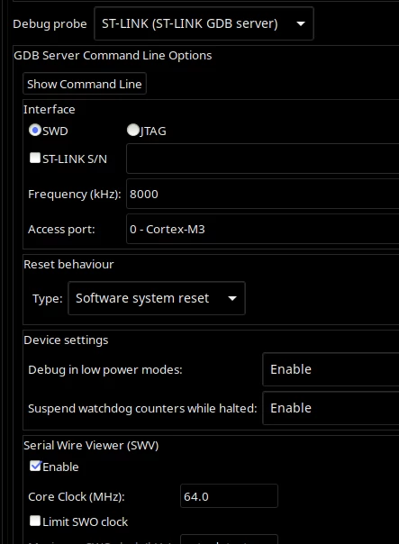

    So why not use this ? (I most times use OpenOCD .)
    > initConfigParams(): cpu-clock 800000
    CPU is at 8M - really ?
    see one of my settings with GDB:
