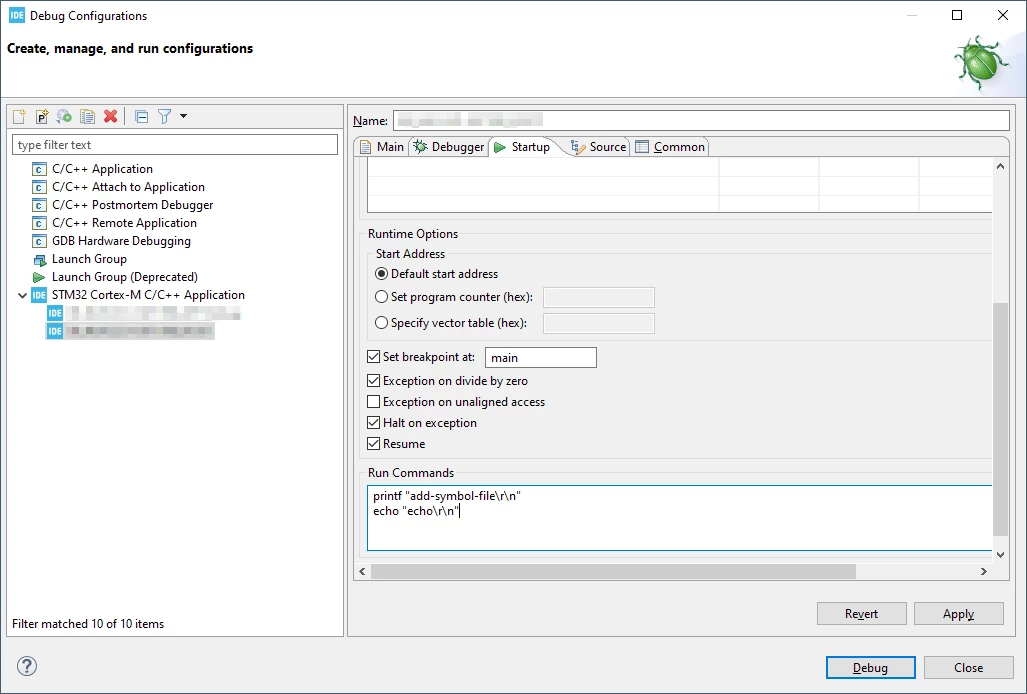

However, I can see gdb is used, and in particular, a gdb script (as indicated by add-symbol-file) is used in Debug Configurations' Run Commands. Since in gdb command scripting there are both echo and printf commands, I thought I should try it in Debug Configurations > Startup tab > Run Commands -- say, the following:
printf "add-symbol-file\r\n"
echo "echo\r\n"
It turns out, that these commands end up in the .launch file of the project:
$ grep -r echo stm32_project_dir/
stm32_project_dir/PROJECTNAME.launch: <stringAttribute key="org.eclipse.cdt.debug.gdbjtag.core.runCommands" value="printf &quot;add-symbol-file\r\n&quot;&#13;&#10;echo &quot;echo\r\n&quot;"/>

However, when I click Run > Debug, and I finally get a connection to the debugger, I cannot see these printouts anywhere -- at least not in the Debugger Console, where I'd have expected they would appear:
0693W00000AMQ6YQAX.pngSo my main question is:
  • Is it possible to use gdb commands like echo and printf in the gdb script in Debug Configurations' Run Commands -- and if so, how? (is there some additional setup; is the Debugger Console the right place to look for these output printouts?)

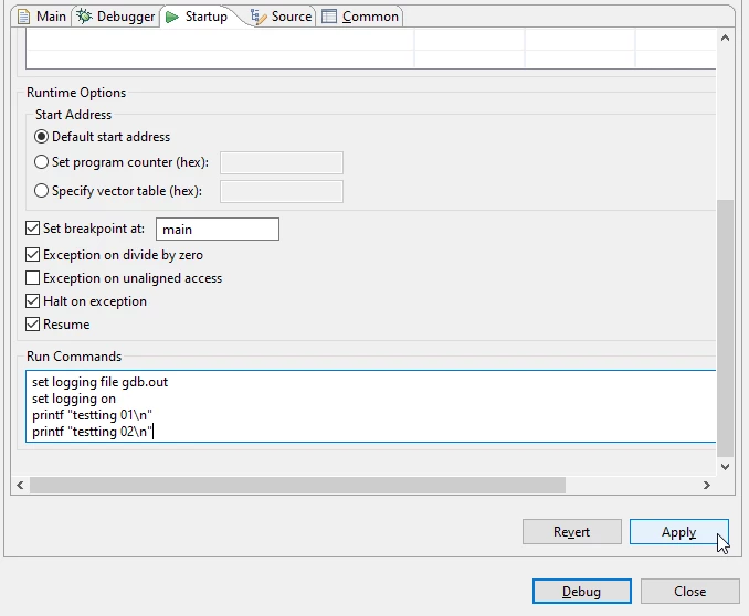

... so I thought, why not try explicitly enabling gdb logging, and see what happens?
So, I entered the below script in Debug Configurations - Run Commands:
0693W00000AMYYkQAP.png... that is:
set logging file gdb.out
set logging on
printf "testting 01\n"
printf "testting 02\n"
Upon starting a debug session, there are still no messages in the Debugger Console - however, I do get a `gdb.out` file, with contents like below;

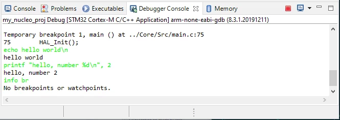

1.It was not quite obvious to me, but you can type in the Debugger Console, once the debugger is halted on a breakpoint; here echo and printf work just fine (however, then you are in the gdb client, so to speak):

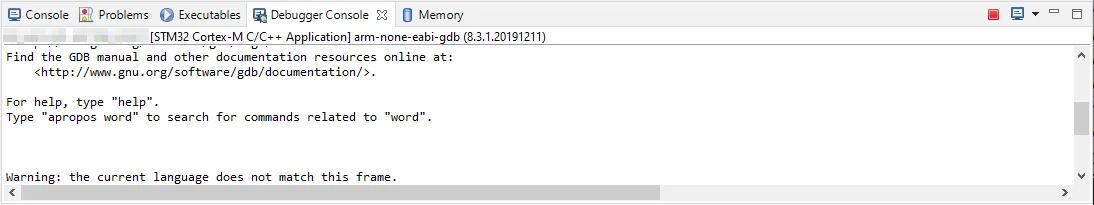

I tried to enable the checkbox "...show GDB traces..." - but I could see no change whatsoever (STM32CubeIDE Version: 1.6.1, Build: 9958_20210326_1446 (UTC) on Windows 10 Home).
On the other hand, I also tried to check "use external console for inferior (open a new console window for input/output)", and I couldn't see any obvious change either (no new console window was opened); as if the C/C++ > Debug preferences are fully ignored for me.
But even if I keep these two unchecked, and go back to Debug Configurations > Debugger > probe: ST-LINK (ST-LINK GDB server) > check Log to file:, Apply and Debug - then I do get some printouts in GUI upon clicks on Resume or Suspend - but in the Console (not the Debugger Console).
