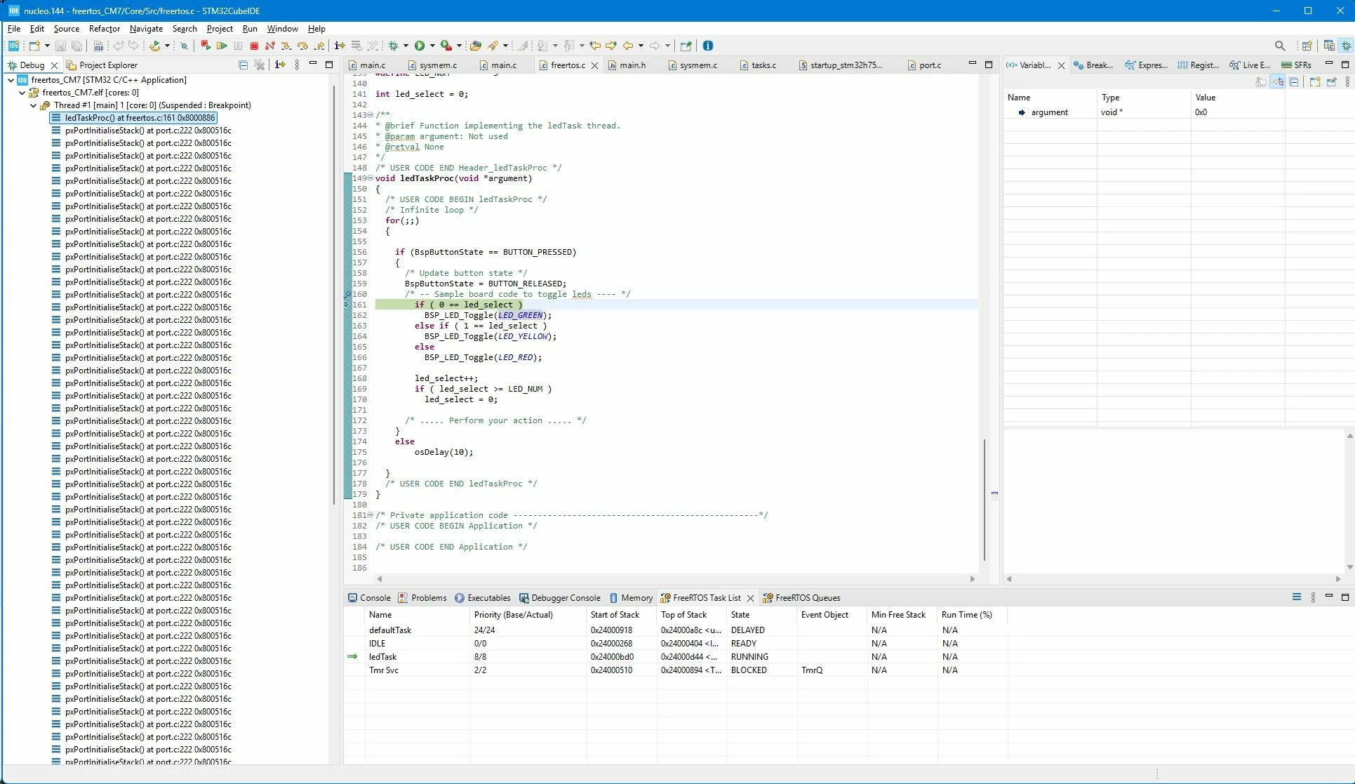

I am testing STM32H755 MPU using the nucleo-144 (STM32H755ZI).
I used the STM32CubeMX tool to automatically generate a basic FreeRTOS example and added an ledTask to toggle an LED.
void ledTaskProc(void *argument)
/* USER CODE BEGIN ledTaskProc */
/* Infinite loop */
for(;;)
if (BspButtonState == BUTTON_PRESSED)
/* Update button state */
BspButtonState = BUTTON_RELEASED;
/* -- Sample board code to toggle leds ---- */
if ( 0 == led_select )
BSP_LED_Toggle(LED_GREEN);
else if ( 1 == led_select )
BSP_LED_Toggle(LED_YELLOW);
else
BSP_LED_Toggle(LED_RED);
led_select++;
if ( led_select >= LED_NUM )
led_select = 0;
/* ..... Perform your action ..... */
else
osDelay(10);
/* USER CODE END ledTaskProc */
The operation proceeds without any issues.
However, as shown in the image, if I set a breakpoint, I see many nested pxPortInitialiseStack() calls in the call stack.
What kind of error could this be? This is not typically seen; is it possible to remove them?
2 replies
Jun 18, 2026 10:06 AM UTC
Hello ​@Cheolhyeon Cho
What you see is usually **not a real error**, but probably a **debugger call-stack unwinding artifact**.
In FreeRTOS, `pxPortInitialiseStack()` is used to build the initial stack frame of each task, and when you stop on a breakpoint the debugger may incorrectly reconstruct the task stack and show many repeated `pxPortInitialiseStack()` entries.
If the application runs correctly and you do not see faults or stack overflow, this can generally be ignored.

Jun 19, 2026 2:48 AM UTC
Hi, Saket.
Thanks for your quick reply.
I understand.
I haven't seen this before.
Is there any way to prevent this unnecessary pxPortInitialiseStack() from being displayed anymore?
I added the following items to FreeRTOSConfig.h.
/* USER CODE BEGIN Defines */
/* Section where parameter definitions can be added (for instance, to override default ones in FreeRTOS.h) */
#define configTASK_RETURN_ADDRESS NULL
/* USER CODE END Defines */
* https://community.st.com/stm32cubeide-mcus-28/freertos-backtrace-problem-159746
Is this a complete solution?
