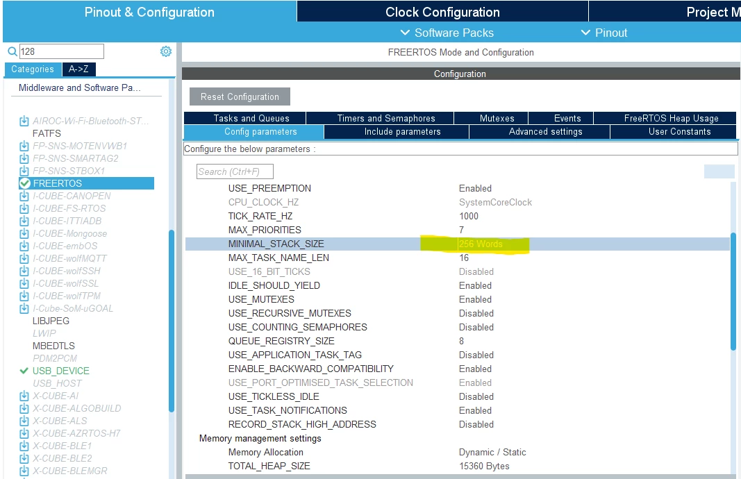

FreeRTOS and USB givers Hard Fault in H743 MCU
Dear Sirs
I am having a problem using FreeRTOS and USB on H7 series MCU. The IDE gives “Hard Fault” when I debug the project. See image below.
The environments are :
STM32CubeIDE:  Version: 1.14.0, Build: 19471_20231121_1200 (UTC)
Target: NUCLEO-H743ZI2
Enclosed herewith are the two “ioc” files.
FreeRTOS_USB1.ioc is for the project without initialization to the USB and it is working fine.
FreeRTOS_USB.ioc is for the project with the initialization to the USB and it is giving my Hard Fault.
Your help and assistance are highly appreciated.

May 25, 2025 4:27 PM UTC
Increasing the MINIMA_STACK_SIZE can solve the problem.

Hi @RAbdu.1542
To address the issue you're facing, I recommend the following steps:
  1. Update CubeMX to latest version.
  2. Compare generated code from working and not working IOC file.
  3. This issue might be linked to CMSIS V1 as you may not increase the stack size for USB task.
