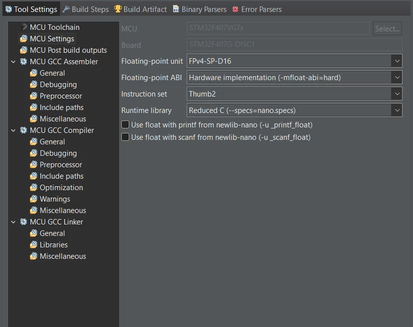

Why does this warning show up every time I create a project. Is it something important, how do I get rid of it if I need to. I checked the settings and I initialized the FPU in properties.

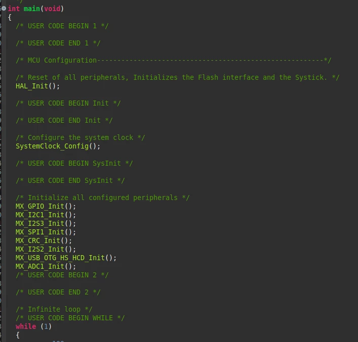

    what did you set in the code generator in cube ?
    your "main" looks totally wrong - not generated for a cube/HAL stm32 project.
    should look like mine here:
    so try: make new stm32 project, maybe for F407 - disco board (i suppose, you have this, as i do), change nothing, just generate code. then look, what it looks like...and only write your code between "user code begin...// ...end " comments.
    + printf ... you know, where it should print to?    better just toggle a LED as a first test. not print...to nowhere.

    The tool settings allow the compiler to generate FPU instructions but you still need to enable it within the code itself.
    #if (__FPU_PRESENT == 1) && (__FPU_USED == 1)
     SCB->CPACR |= ((3UL << 10 * 2) |
     (3UL << 11 * 2)); /* set CP10 and CP11 Full Access */
    #endif
