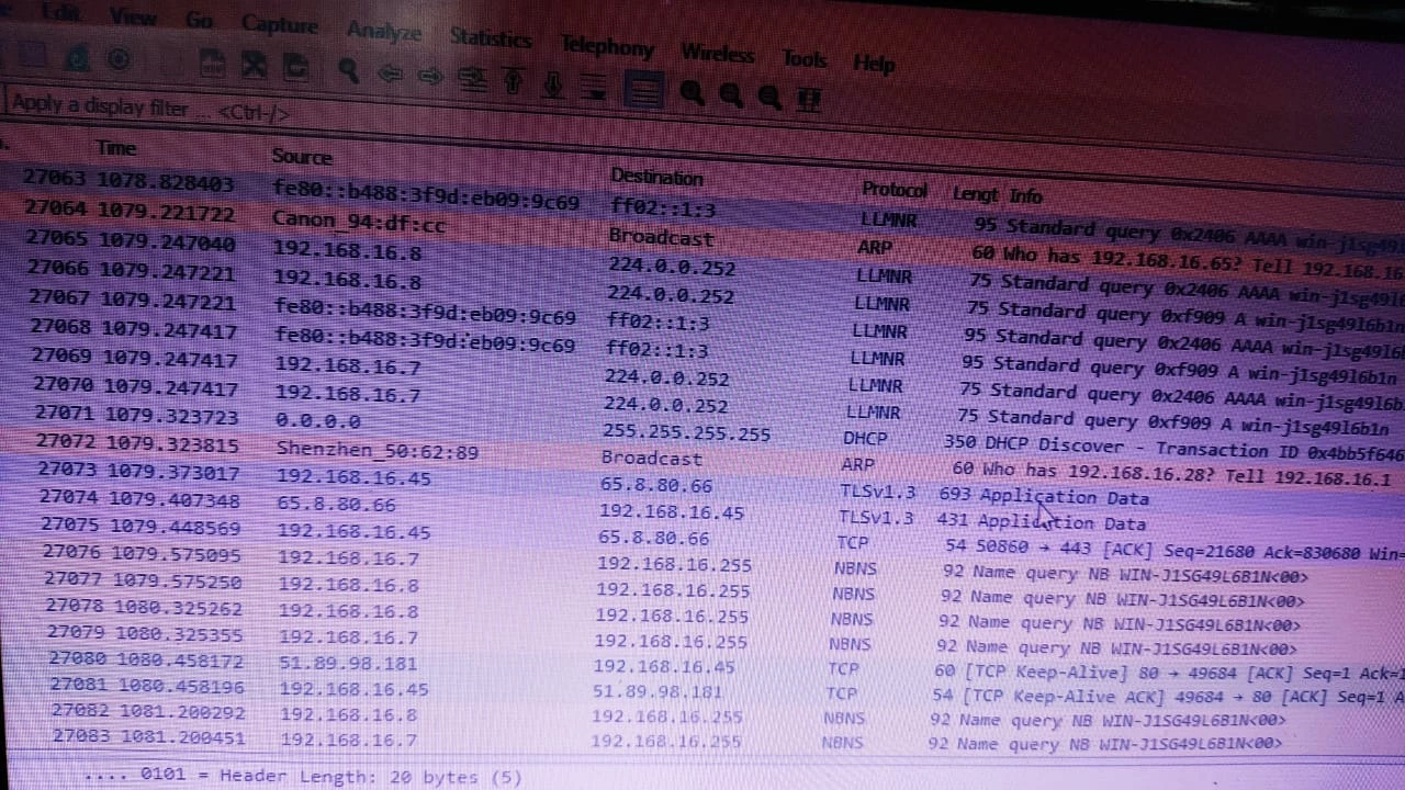

After closely monitoring each and everything using wire shark I realized following
While using DHCP:
STM32F7 sends some DHCP discovery message with a length of 350 bytes may be ,
but still unable to acquire IP address I thing STM fails to perform further handshakes or protocols which might to necessary to acquire an IP address from router.

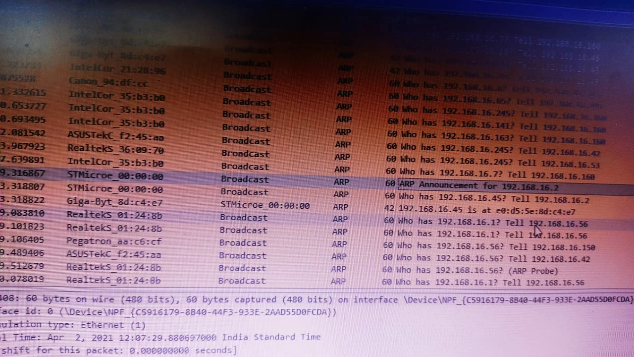

While using Static IP:
results were same but this time ARP protocol comes in play broadcasting the message announcing for 192.168.16.2(static IP).
my program was trying to send data using UDP protocol so again ARP tries to locate my PC(IP-192.168.16.45) and my computer actively responds to the request by sending its MAC address to STM.
but after this I am unable to record any packets transfer.
but my PC-NIC card manages to store data that ip:192.168.16.2 device is present in the network when i use command "arp -a" in my command prompt but still unable to ping
after seeing this I concluded myself that may be STM got some trouble receiving data.

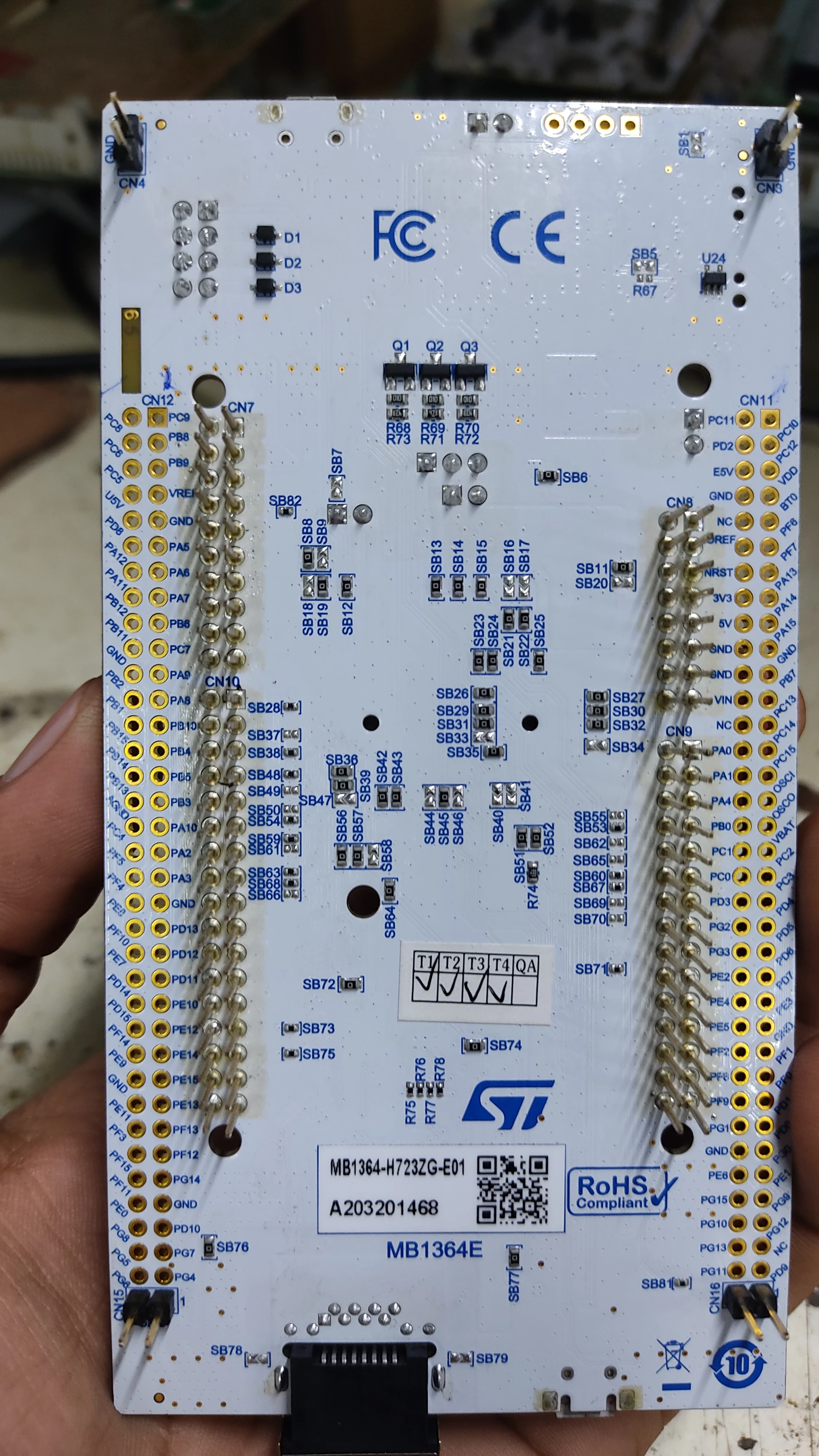

last but not the least pdf file page number 28 to verify the jumpers of ethernet but I feel sorry to say that I can hardly find 3-40693W000008ydPRQAY.jpg jumpers remaining jumpers is not present in my board and i also double checked that I am working with STM32H7 series board.
kindly help me with this issue I can not proceed further without your help.
help me find the correct solder jumper state for STM32H723 board

Hello @Community member​,
The board's MAC address seems fishy (ends with 00:00:00). Could you provide how you did the initialization?
Otherwise, the MPU should not have any functional interaction with ethernet.
