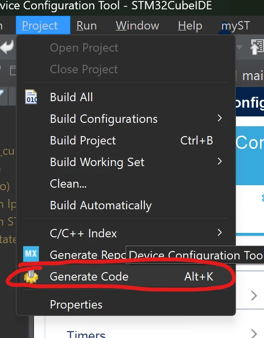

Hello everyone,
I have the problem that only these 2 files are displayed on my Project Explorer. Once testpro and testpro.ioc all other files are missing, for example the C program main.c. My question is can someone help me to fix this problem?

Okay so MacOS.
Not sure how the screenshot helps here. Did you try the project menu? Show it
> it says that the code is being generated
Perhaps you need to log in or download the relevant software packages in Help -> Manage Embedded...

Code must be generated after you configure the IOC file. To generate code, go to Project -> Generate Code

If i go to project, there is no generate code. And if i go to the bar at the top, it says that the code is being generated, but then nothing comes up.

Okay so MacOS.
