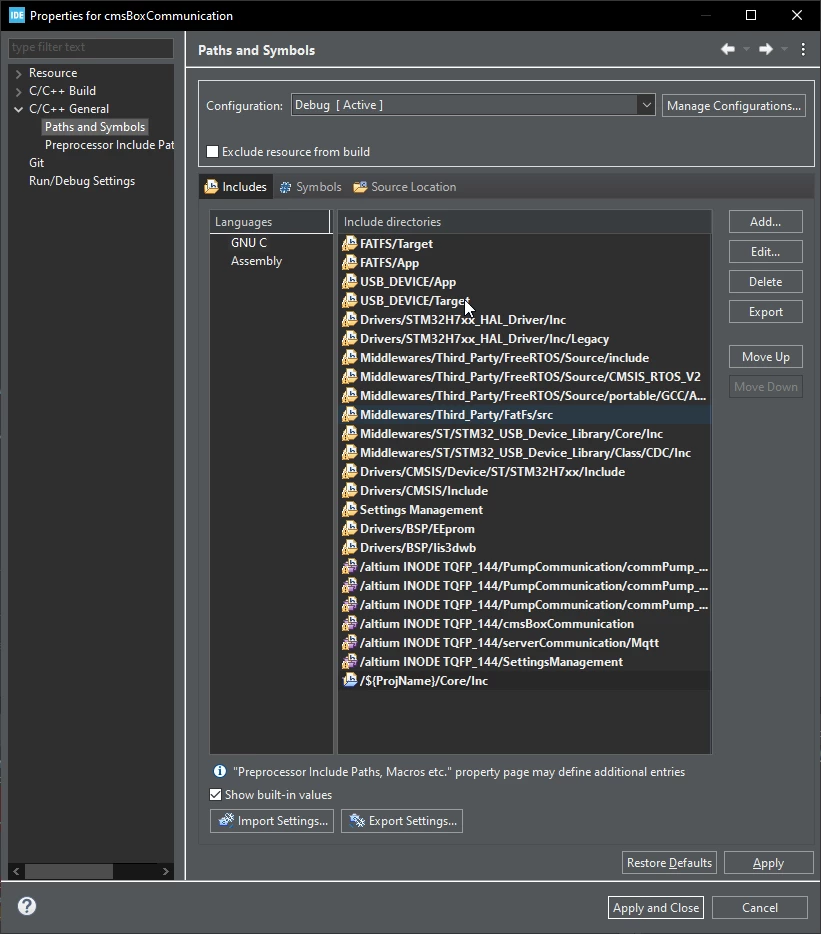

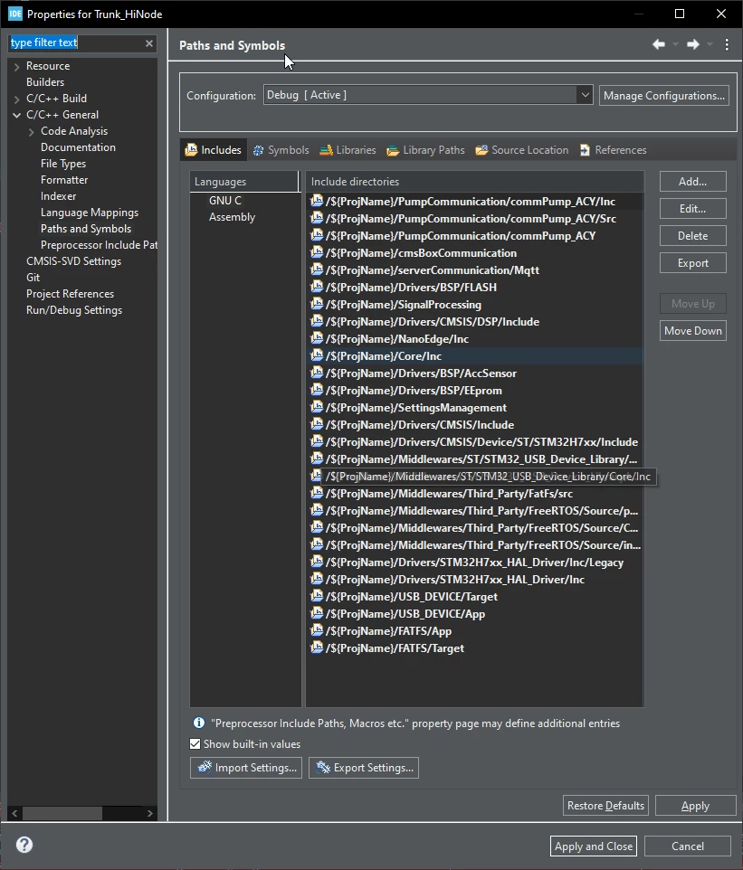

I just imported a shared project from DevOps and I had to change some absolute paths to project relative paths in Project Properties-C/C++ General-Paths and Symbols-Includes.
Now I am still facing some errors like: "...No such file or directory".
When I check the folder where the file that generates this error is located, I see it does not have the same settings that I just set before in Paths and Symbols. I precise the folder is part of the project.
Here are project properties:
And here are folder properties:

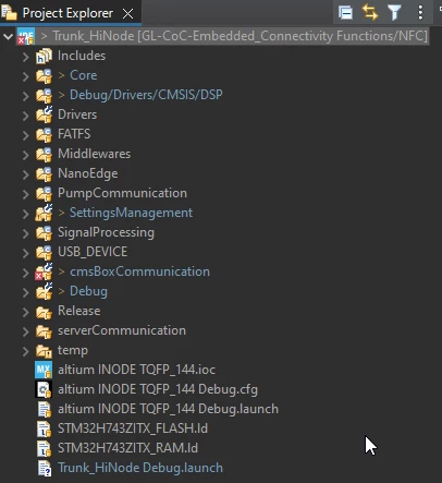

Here is the project structure:
The folder that does not have project settings is "cmsBoxConfiguration", which has the "key" symbol. Folder with the blue C symbol have same properties than the project.
Is sometinh wrong with the project configuration ?

Those two screenshots are from different projects.
What is the exact error message? What project are you trying to compile?
