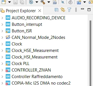

Is there a possibility to create folders in which to place projects in order to better visually organize all those in the workspace?
For example in the picture below there is only a small part of the long list of my projects in "Project Explorer" ... can I create folders visible in the "Project Explorer" in which to place/categorize projects?
I kindly ask is there anyone can guide me step by step because in the past I made some mistakes that cost me the loss of some projects I don't know in what remote parts of the computer

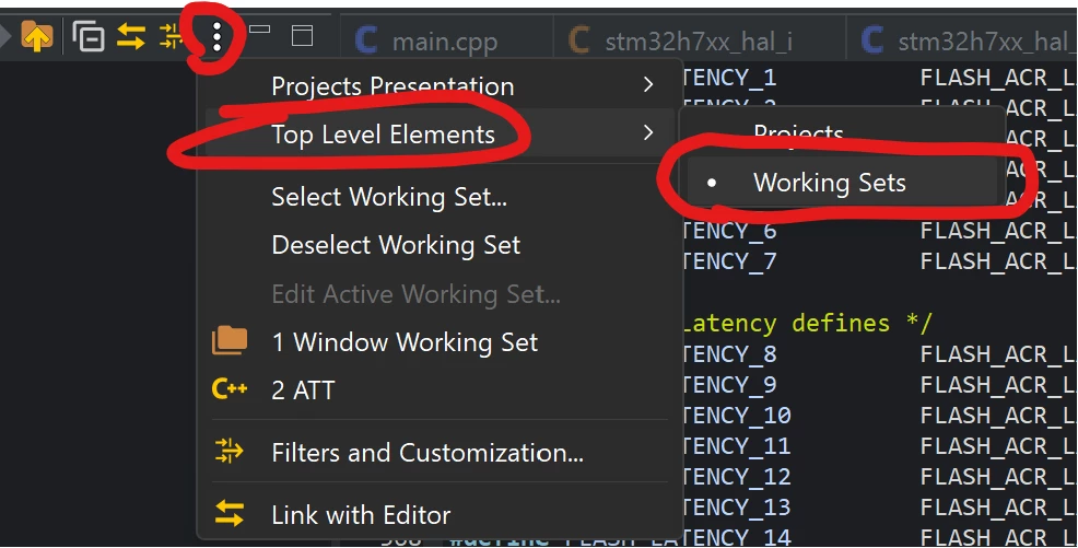

    You can't create folders, but you can organize your workspace into working sets, which is effectively the same thing.
    Set up your workspace to show working sets at the top-level instead of projects:
    Then create working sets and add your projects to them within Select Working Set... -> New -> C/C++ -> (select projects)

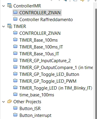

    luke514Author
    January 4, 2024
    Thank you.
    It should appear like this, right?
    January 4, 2024
    You got it. It's a little more organized that way, right?
