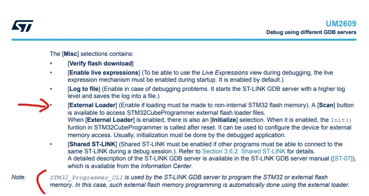

I've successfully created a custom flash loader for the STM32H7A3ZIT6Q with the MT25TL256 dual-quad NOR FLASH. I can erase, program and read the external memory in STM32CubeProgrammer with a dummy file. Flashing an elf file with external flash data fails.
Memory mapping also works in my STM32CubeIDE project. The project has some dummy data in the external flash section. It shows up in the Build Analyzer. I can export the external memory section to a bin file, which I can manually flash with STM32CubeProgrammer. If I debug my application I can see the dummy variable is correctly initialized and in the right location.
I use the following post-build command to export my bin file:
arm-none-eabi-objcopy.exe -O binary --only-section=.textqspi "${BuildArtifactFileBaseName}.elf" textqspi.bin
I've added my flash loader to a new launch file and I get the following output:

I have a workaround.
In the linker file I no longer put the external flash after the internal flash:
.textqspi :
 . = ALIGN(4);
 _qspi_start = .; /* create a global symbol at qspi start */
 *(.textqspi) /* .textqspi sections */
 *(.textqspi*) /* .textqspi* sections */
 . = ALIGN(4);
 _qspi_end = .; /* define a global symbols at end of textqspi */
 } >QSPI
 /*>QSPI AT> FLASH this didn't work!*/
This changed my elf file from:
Program Headers:
 Type Offset VirtAddr PhysAddr FileSiz MemSiz Flg Align
 LOAD 0x010000 0x08000000 0x08000000 0x002ac 0x002ac R 0x10000
 LOAD 0x020000 0x90000000 0x080002ac 0x00014 0x00014 R 0x10000
 LOAD 0x0202c0 0x080002c0 0x080002c0 0x114240 0x114240 RWE 0x10000
 LOAD 0x140000 0x24000000 0x08114500 0x004e8 0x004e8 RW 0x10000
 LOAD 0x140500 0x24000500 0x081149e8 0x00026 0x00026 RW 0x10000
 LOAD 0x140528 0x24000528 0x08114a0e 0xbb800 0xc8328 RW 0x10000
 LOAD 0x008850 0x240c8850 0x081d020e 0x00000 0x00600 RW 0x10000
to
Program Headers:
In my launch file I added the external flash loader and set initialize to disable. I can now flash the elf file with STM32CubeProgrammer and I can debug, but not flash the external flash, in STM32CubeIDE.

So it kind of works, but, I wish there is a way to get it working properly.
EDIT: I just discovered it works in STM32CubeIDE. With external memory initialize set to disable it will flash it anyway. But it will crash when I enable it. I don't understand the logic of it, but it works! Somehow there are occasional read errors with the flash chip so I reduced the clock speed from 70MHz to 56MHz
