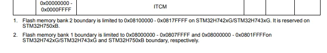

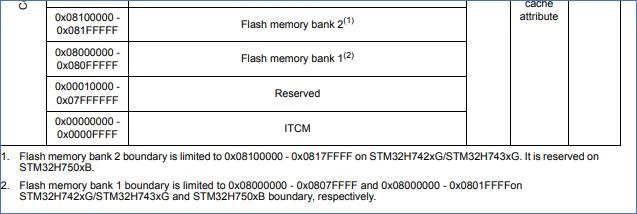

    But i think it's not authorize because i read these comments is the reference manual :
    So, i suppose it's not authorise to grow up the FLASH1 in my case. What is your opinion about his subject ?

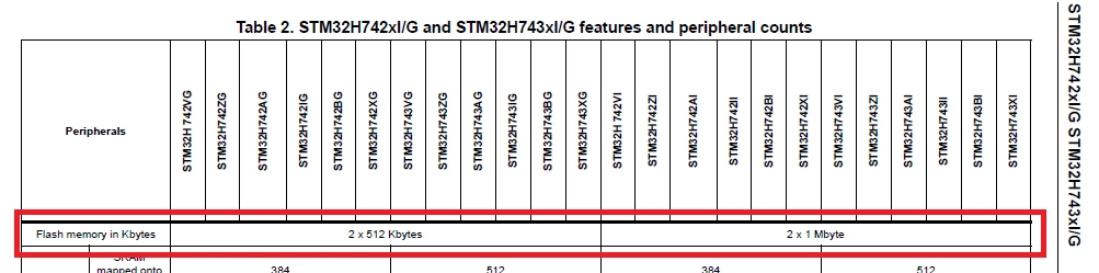

    This is what you have to take into account (From the datasheet Table 2). The flash size config depends on the device:
    For the config 2 x 512k the flash is not contiguous. So you are limited to 512k for each bank and you cannot bond them. For the second case: 2 x 1M: you can use all the 2M without issue. The two "1M" are contiguous.
