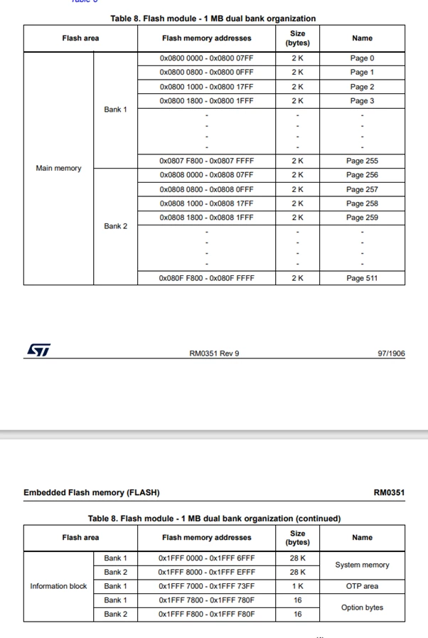

Flash Space calculations STM32L496RGT6
Looking into the available flash space on the chip:
For the 1Mbyte variant of the device the total number of bytes should be 1,024,000.
2,000 bytes * 512page = 1,024,000 bytes of flash memory.
End of Address Space - Start of address space  = Amount of total space
 0x080F FFFF -  0x0800 0000 = 0xF FFFF bytes = 0d1,048,575 bytes
Am I incorrectly calculation incorrect ? If not where's the missing 24,575 ?
Thanks
    TDKBest answer
    December 8, 2023
    1MB = 1024^2 bytes
    The flash length is 0x10 0000, which is 1024 * 1024 = 1048576 bytes = 1 MB.
