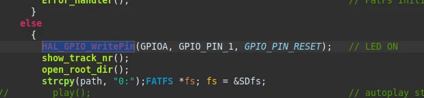

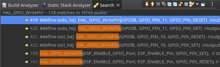

in IDE -> edit window : mark some text with pressed left mouse button ;
then right click mouse ->
search text -> project
you get:
0693W00000aJVqKQAW.pngok ?

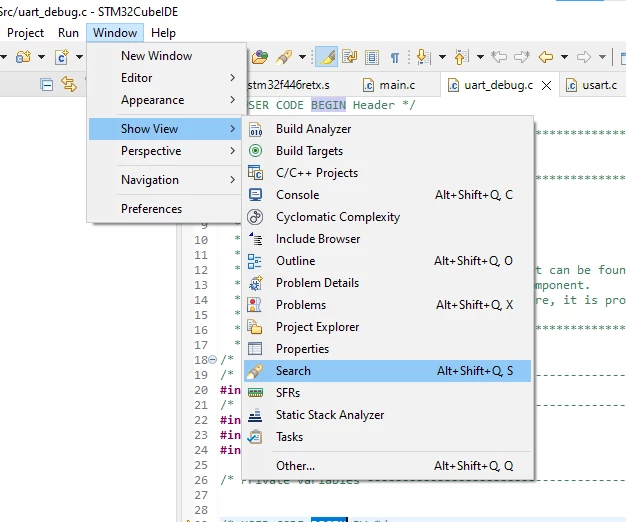

Sometimes Eclipse does not show the tabs/views automatically and they remain hidden.
In this case you can force showing any view by Window-> Show View ...

That sounds too good to be true... Unfortunately the search tab is not displayed, neither automatically nor with Window.Show View.Search
0693W00000aJZJeQAO.pngThe search text in the active file is marked, so the search seems to be executed, but the results are not shown?!
