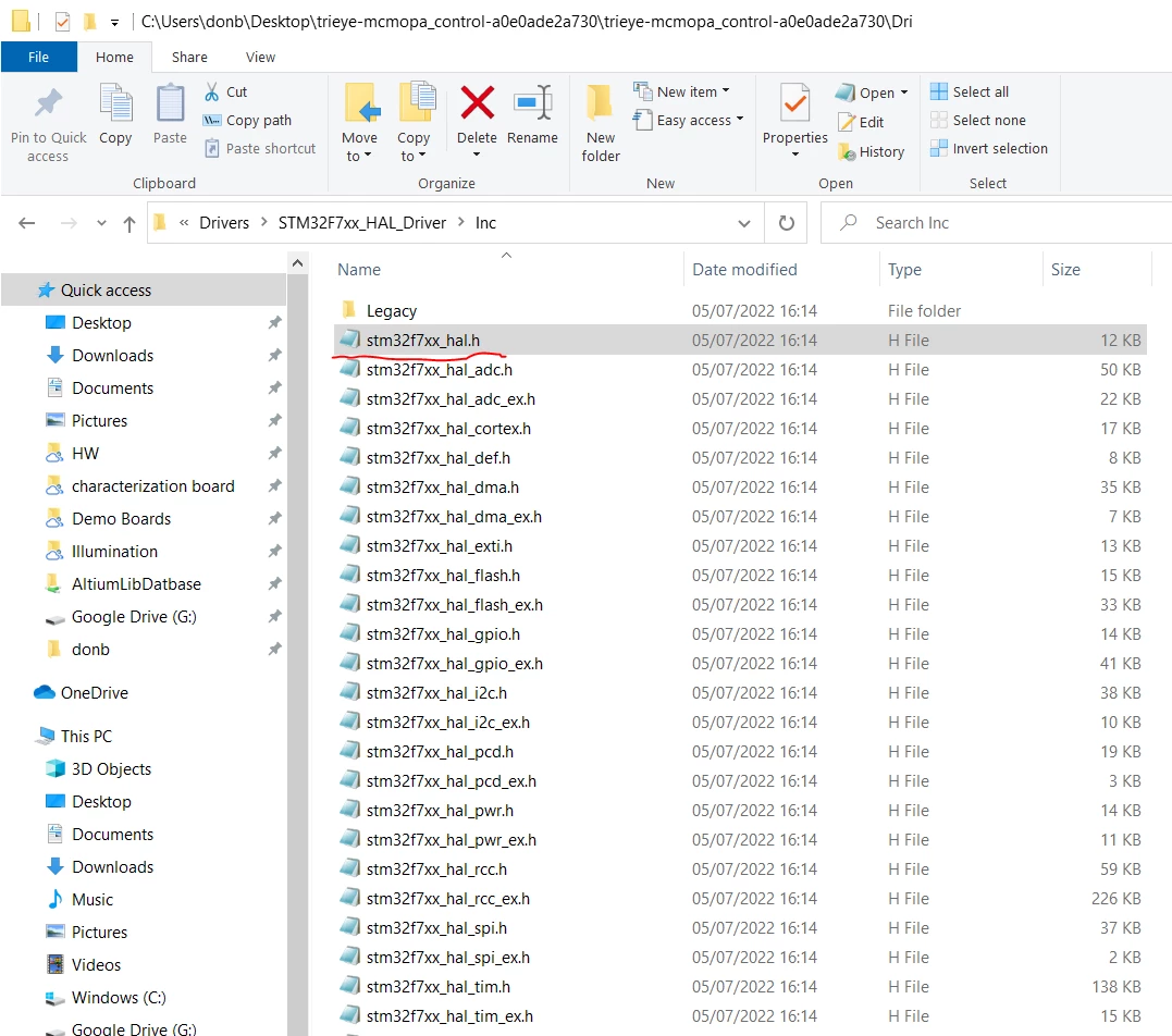

I am trying to compile code that works fine on my friend's pc.
the problem is that I am keep getting error that the compiler can't find the "stm32f7xx_hal.h" file even dough its there and I added it to the include paths.
can someone help?

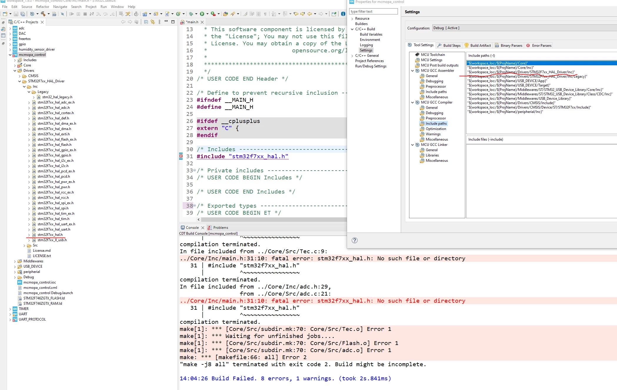

Check the compiler options in the build console view for the correct -I includes.
Check for spaces or other non-trivial or non-ASCII characters in the path like umlauts, quotes, ...

I'm not an Eclipse/CubeIDE adherent, but is a "Project Tree" actually a directory? Will the file load into the IDE if you click on it? What path does that show?
Show me this in a File Manager.
Make sure that whatever environment variable expansion you have in your Include Paths list actually expands to what you think it does.

The screenshot shows workspace_loc and ProjName used - so check that they are actually pointing to the correct places...
And, as @KnarfB​ said, check for "weird" characters in file (including folder) names;

dboia.1
dboia.1Author
July 13, 2022
the file does exist in the file system and there are no  "weird" characters
Andrew Neil
July 13, 2022
and are you sure that folder matches your Include paths - after the symbols are expanded?
