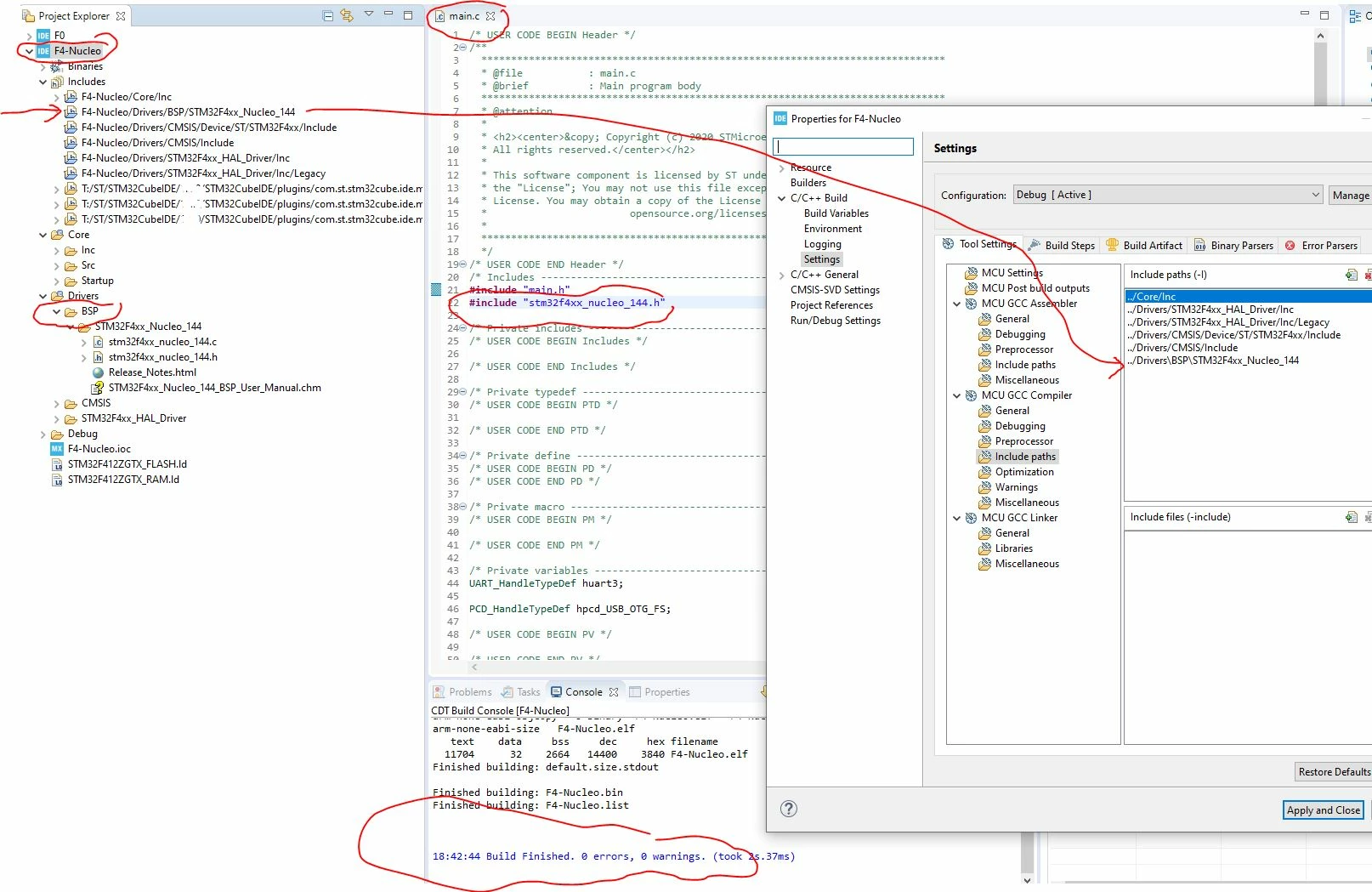

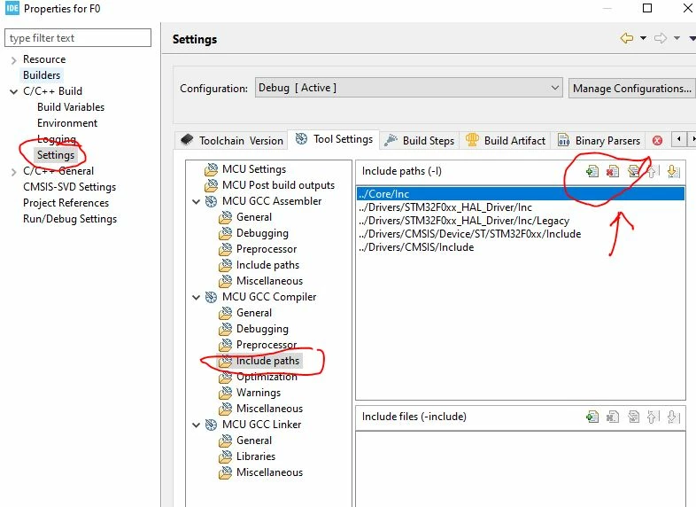

Right click on your project within Project Explorer then "Properties"
As addon here is my setup adding BSP without any issue

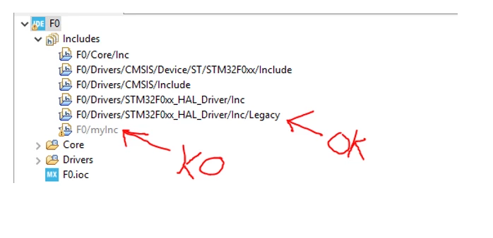

Project->Properties->Tool Settings -> MCU GCC Compiler -> Include paths Add "Drivers/BSP". It is visible as "../Drivers/BSP" Any suggestions as to how to make that line effective?
Cartu38 OpenDev
Graduate II
July 24, 2020
Is such line effective from Eclipse point of view already ? Please could you check if such line is leading to plain or grayed include like following sanpshot ... if grayed means Eclipse not able to reach
warm38
warm38Author
July 24, 2020
Thanks again. I'm back in business.
