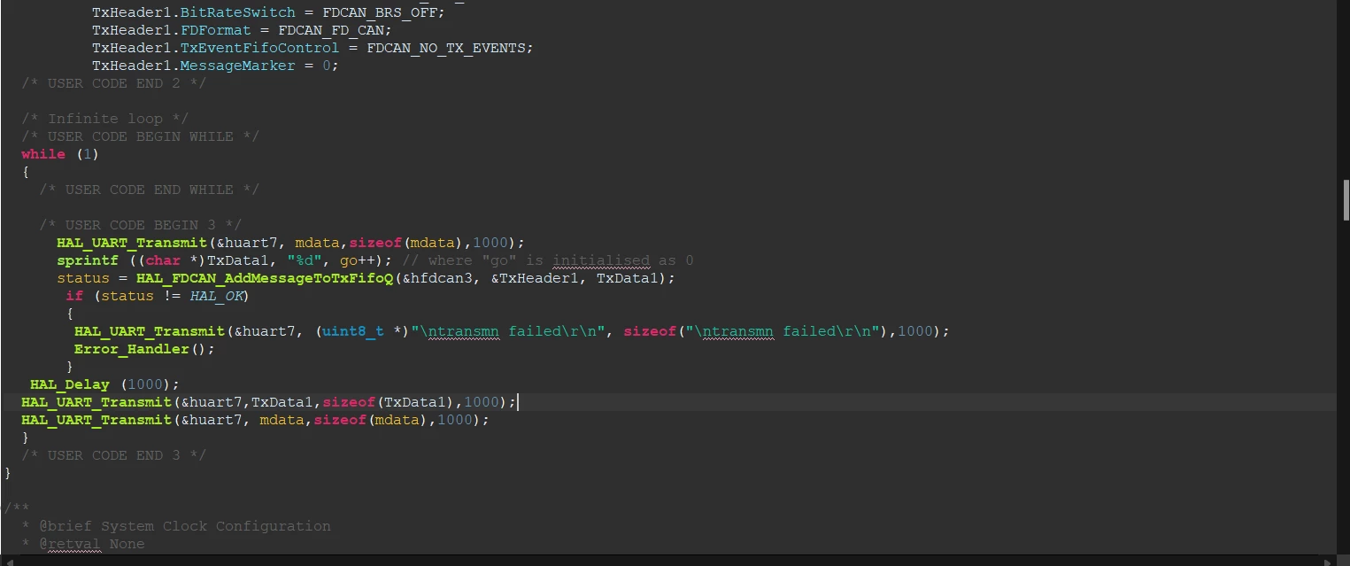

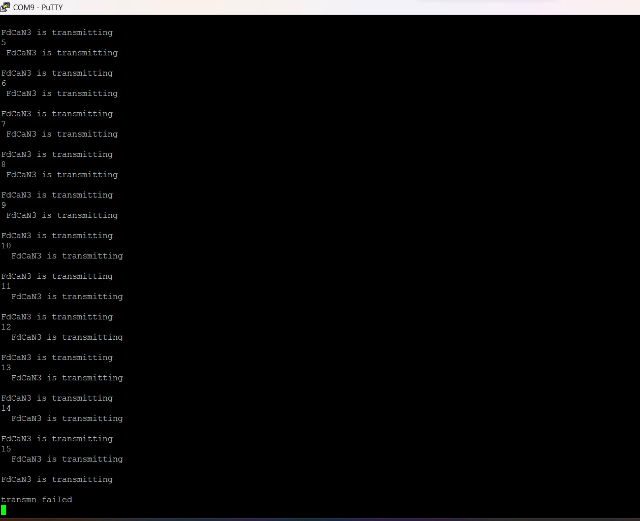

I am only able to transmit till 15 when i am continuously trying to transmit values upto 200 and after 15 my transmission got failed.
The transceiver i am using :- TCAN1046ADRQ1
I am also attaching my SS of the code and output.

    That sounds like your TX FIFO is full.
    Do you have another client to ACK these transfers?
    Check with a scope if the other side actually ACKs the transfers.
