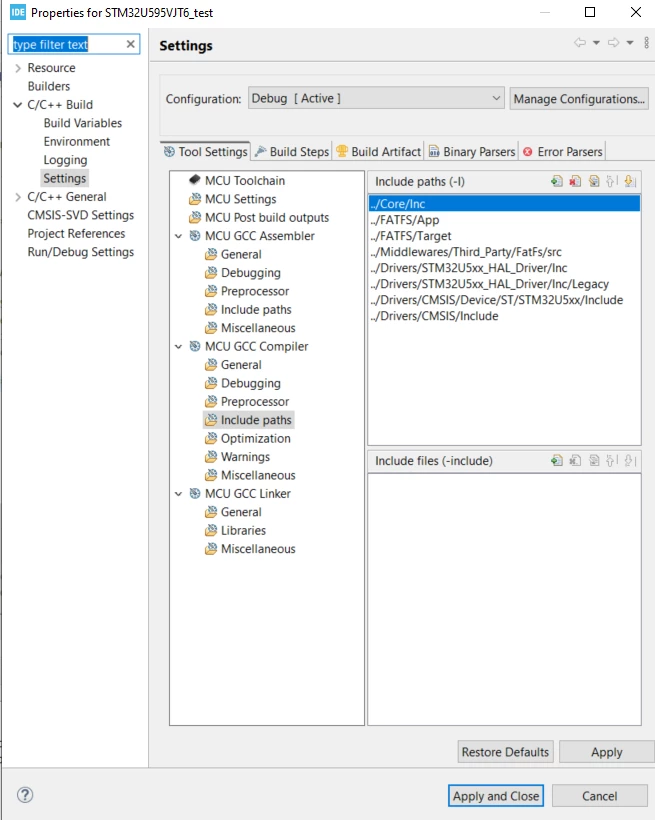

I am considering the STM32U595VJT6 for use in an upcoming design, and found that when I looked on STM32CubeIDE that the FatFS Middleware is missing. Is this something that can be added to the project? Or is there a better alternative for interfacing with an SD card? I find it odd that this chip with 2 SDIO doesn't support FatFS on the IDE yet.
On another note, I have tried to copy the included files from another project where FatFS worked, but I get an error that MX_FATFS_Init() is undefined. I have included my code below, where I have made clear #include for the fatfs.h and I've made sure to include the path for these files in compiler include paths. I thought that including the path would fix it but it didn't. I was able to fix it by moving all the c and h files into the Inc and Src folders. What is the correct method of including a new path? And would this method work with the actual MCU? I don't have one here to test if this works.
Shown below is a picture of the Include Paths that I defined (the three FatFS paths):

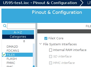

No - i just try new U595 project, can select FileX  ( the part of Azure you need for FAT on SD..)
and ThreadX , if you want (= Azure rtos )

STM is forcing us to use Azure/rtos with Filex to have FAT access to SD or USB MSC on new series,  like H5 etc.
But you can use still , what you want, just more work to get it ;  see:
https://github.com/STMicroelectronics/stm32h5-classic-coremw-apps
  • Third parties' stacks: FreeRTOS, FatFS, and LwIP
If you want "copy" something to new project , use "import" :
- (menu) or mouse right click on your new project folder -> import.. -> file system -> from directory ...
select source dir , type of .c (or .h ) , destination -> into folder ....
and then same for .h files .
Then the IDE "knows" about, these files are in this new project now. (copied).

I have looked into using the Azure RTOS but that is also not supported for STM32U5 boards. FreeRTOS is there, but not Azure RTOS. I have found Azure RTOS in the Software Packs Component Selector, but they seem to be for specific series, such as the F4 F7 L4 H7 etc.
This function is generated by the Cube where the FATFS component is available. You can write your own.
Please refer to the CubeIDE user guide, it explains this.
