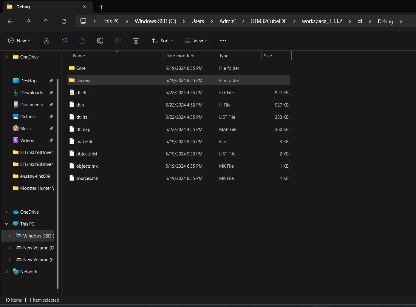

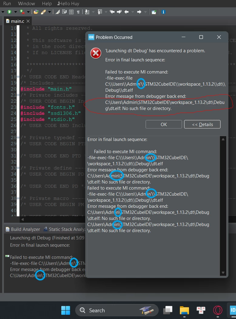

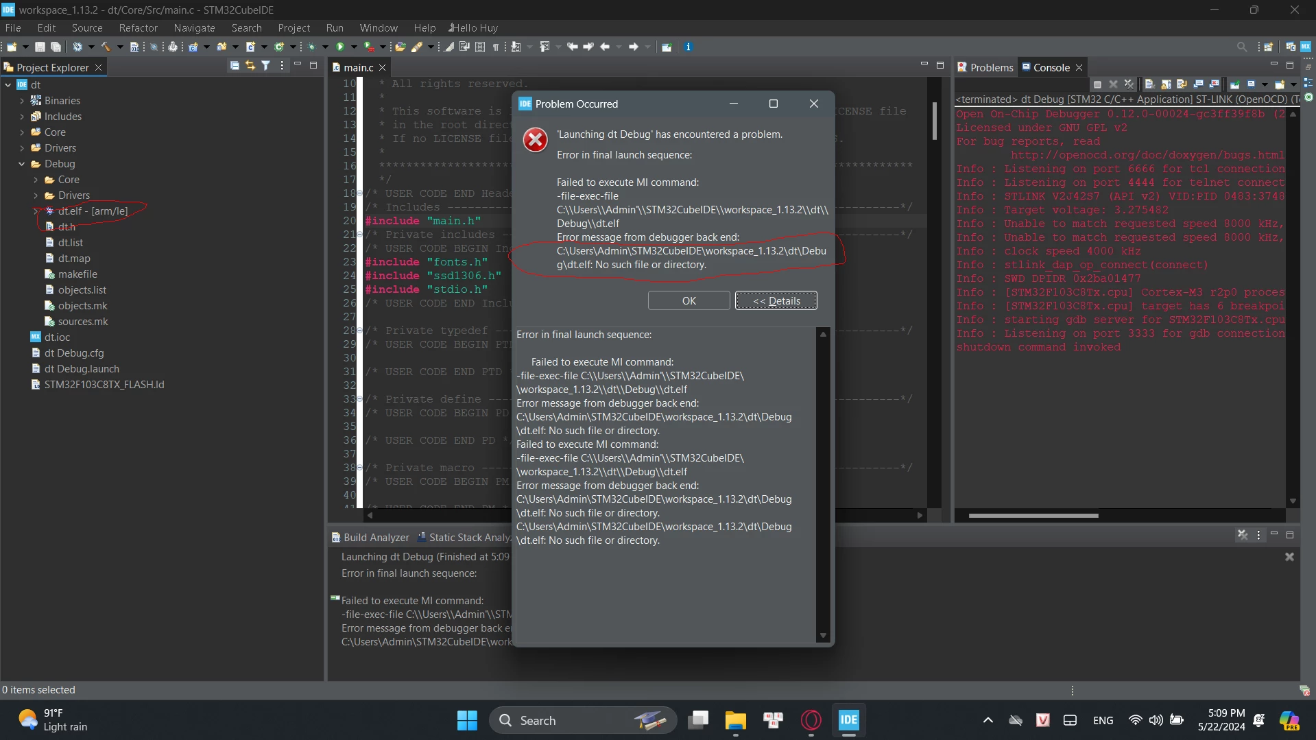

I’m trying to build the tutorial project at https://www.micropeta.com/video43 using STM32CubeIDE , I’ve tried it for the stm32f103c8t6 and it builds without error but when I tried to debug it said that these no such dt.elf file or directory. I have check the workspace and the dt.elf is literally these. I even tried to Inclued the dt.elf manualy but it still didn't work
Can someone help me figure out what I am doing wrong?

Spaces or special characters in paths can cause issues.
Please remove the single quote from the username or use a different path. I usually put my projects in a folder directly in my root directory to avoid paths that are too long or have spaces.

dt.elf is a binary auto generated by the tool after compilation.
dt.elf needs to be in Debug folder. No need to move it to other location.
Could you please share your project so I can have a look at?
