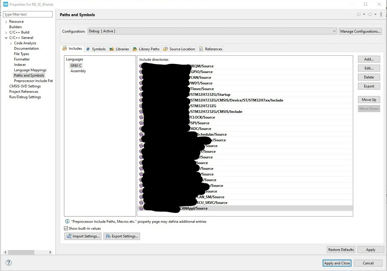

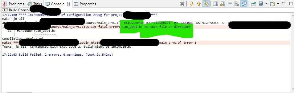

Hi everyone,
I started getting fatal error for the file which is in the project location. I have also added the path in the IDE.
I am attaching the screenshots which might be helpful for you to provide the solution.
Sorry for the rubbish image. Had to do it so for a reason.
Regards
Arrhenius

Does the file exist? Where? Is that location included in your path?
Could also be an issue with spaces or non ascii characters in path.

Hi @TDK​ ,
Yes the file exist in the project folder.
I have included the path.
I am not using spaces, rather I am using underscores.
Regards
Arrhenius

Do you have any non-ASCII characters in the paths? For example if the username contains non-ASCII characters? Can you access these paths outside of STM32CubeIDE context?

Hi @Markus GIRDLAND​ ,
The path contains only ASCII characters.

Hi @Markus GIRDLAND​ and @TDK​ ,
I found the solution to the problem.
The issue was in the include paths updated in the project properties were not reflected under folder hierarchy.
I used export option and that's all. It started working.
