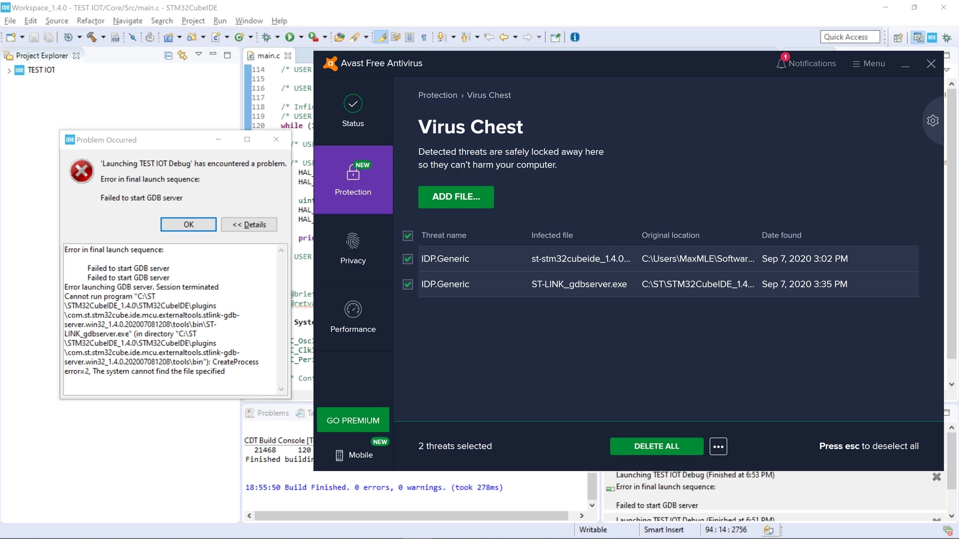

hello forum,
I am getting following error - see picture
https://i.imgyukle.com/2020/09/07/xXWynv.png
I use blue pill f103c8 - voltages are ok - blue pill is alive I can see the LED blink
original st link v2 LED is red - driver is ok no error in device manager
I connected SWD pins
please advise
thank s

elmxmle
September 7, 2020
I had the "Failed to start GDB server" issue at the second launch of a fresh installation of STM32CUBE IDE 1.4.0
I reinstalled the IDE but it did finish the installation and disappeared... oO'
... Avast ate those files in secret ... -__-
Hope this can help some of you to save time with this issue.
Bonne journée.
Max.
