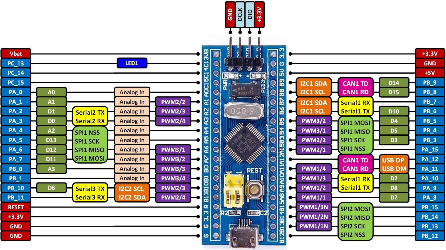

hi guys
could you help me to fix this problem ?
i can programming my program with STM32 ST-LINK Utility and its worked but when i use Run OR Debug in stm32cubeide it does problem
my board and my programmer is in the attechments

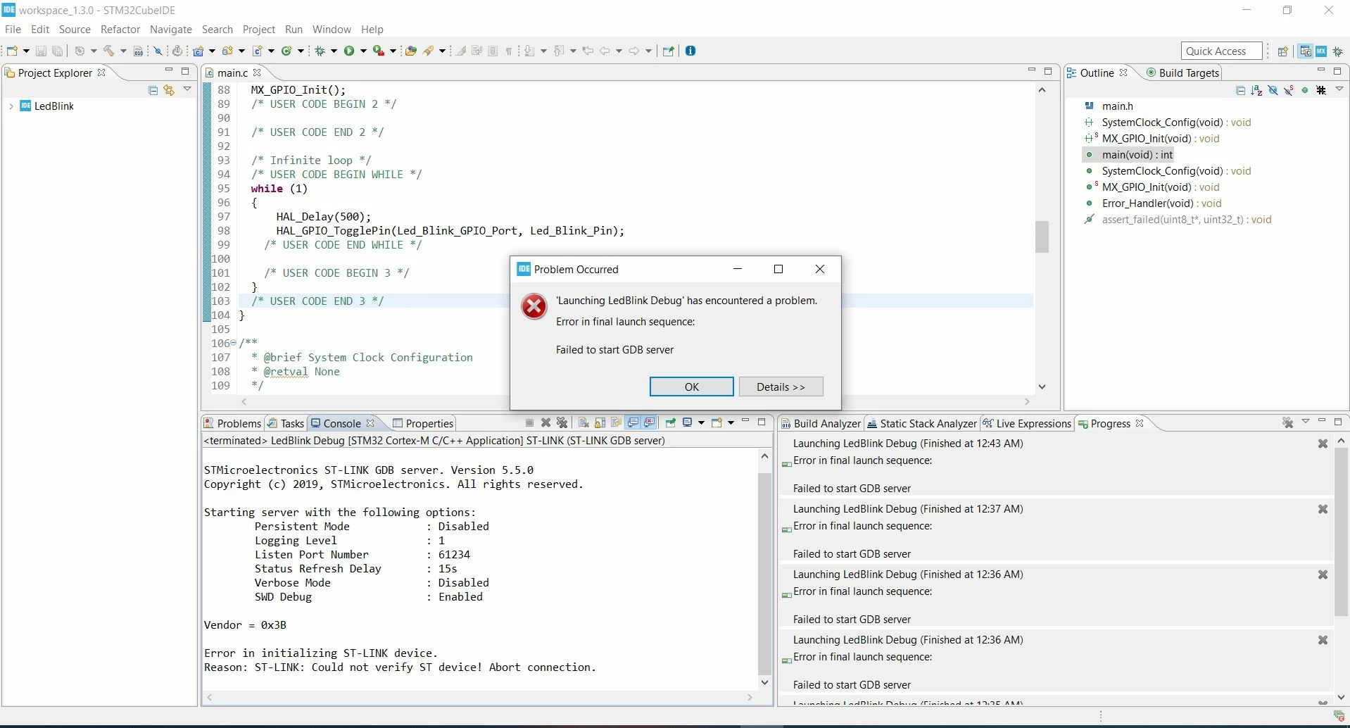

I tired of stm32cubeide it does error gdb server
I can program with keil and its work on my board but it has problem too, when i want to program or debug it take error "Not a genuine ST Device! Abort connection"
Also I upgrade firmware st link

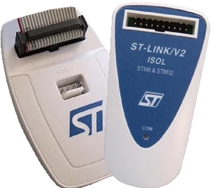

Добрый день, Павел. С �?той ошибкой иногда �?талкиваю�?ь - непред�?казуемо - в проце�?�?е работы. Пока вывод - не оригинальные Сви�?тки �? �?лиек�?пре�?�?, к�?тати за 2 недели внезапно умерли 2 штуки((( - они давали большую ча�?ть ошибок . По�?тавил оригинальный st-link2 == 2 дн�? полет нормальный. Один умерший Сви�?ток �?ам переделал дл�? отладки (вывел �? него на те�?тируемую плату линии SWO + RST, необходимо�?ть RST в данном варианте отладки SWV так и не пон�?л - работает и �?ни и без, вкл. программный ре�?ет)

He wrote that unoriginal ST-LINKs from Aliexpress could be causing this problem. Then he took an original ST-LINK and had no problem for 2 days at least. Also he rebuild his invalid st-link connecting swo and rst pins to target board.

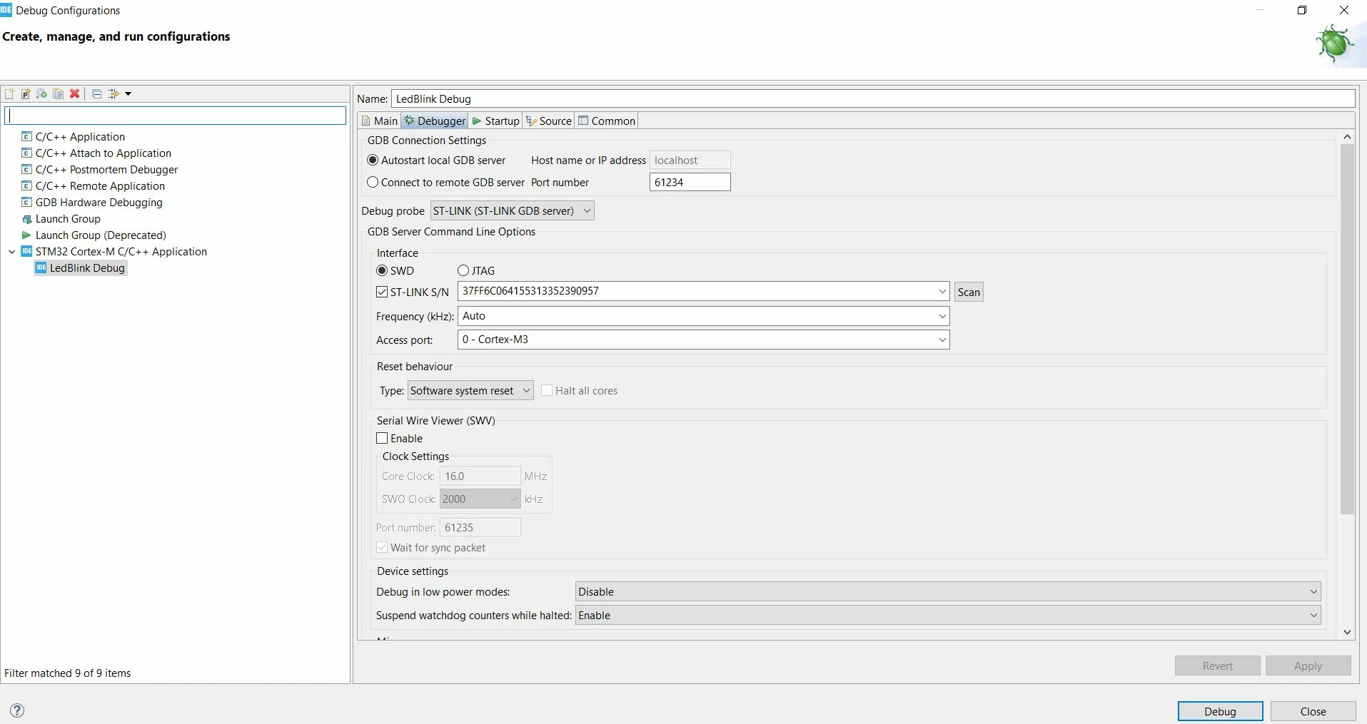

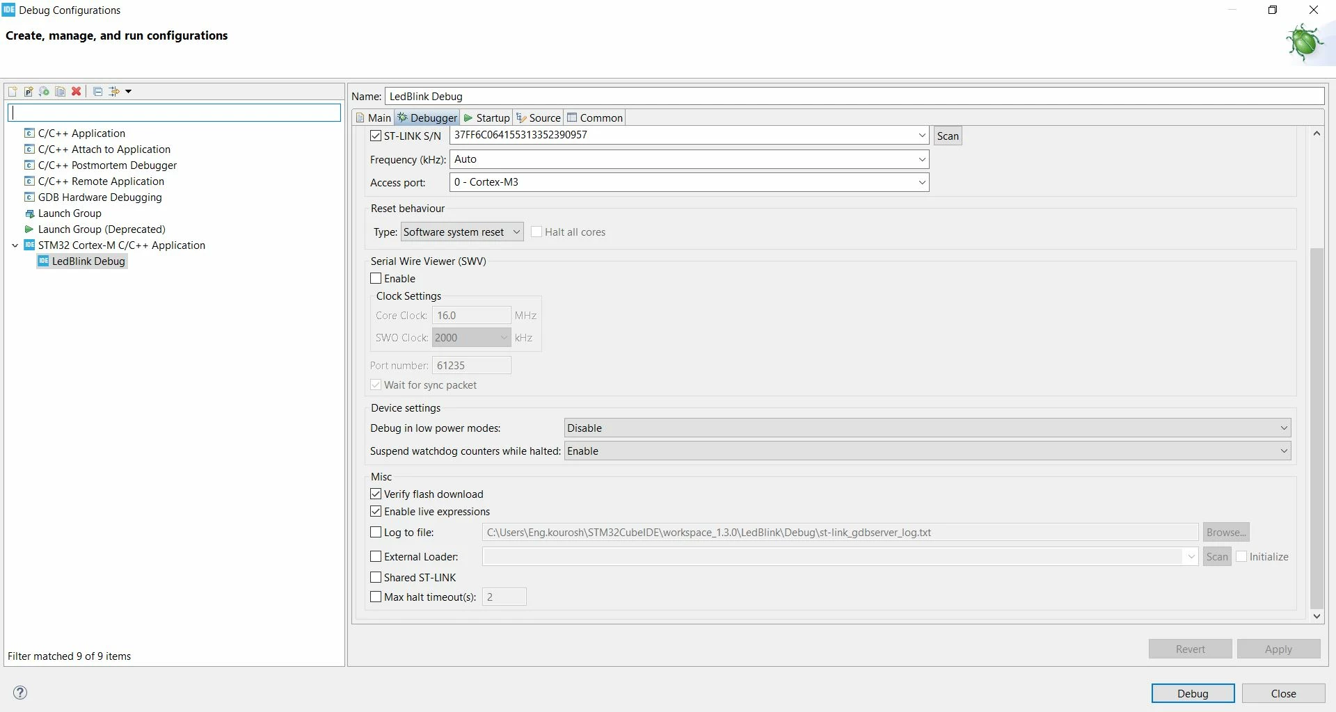

It seems as bug of CubeIDE and developers of ST don't pay any attention to this. In my case with STM32L1 series I faced with same problem with CubeIDE v1.4.0 and ST_Link v3 and solved it just by searching "right" settings. Right settings was: reduce frequency to 21 MHz instead of maximum possible 24 MHz and set "Debug in low power mode" to "No configuration" ("Disable" doesn't help).

Sefo - You failed to mention -where- these changes are to be made ! I can't find them.
