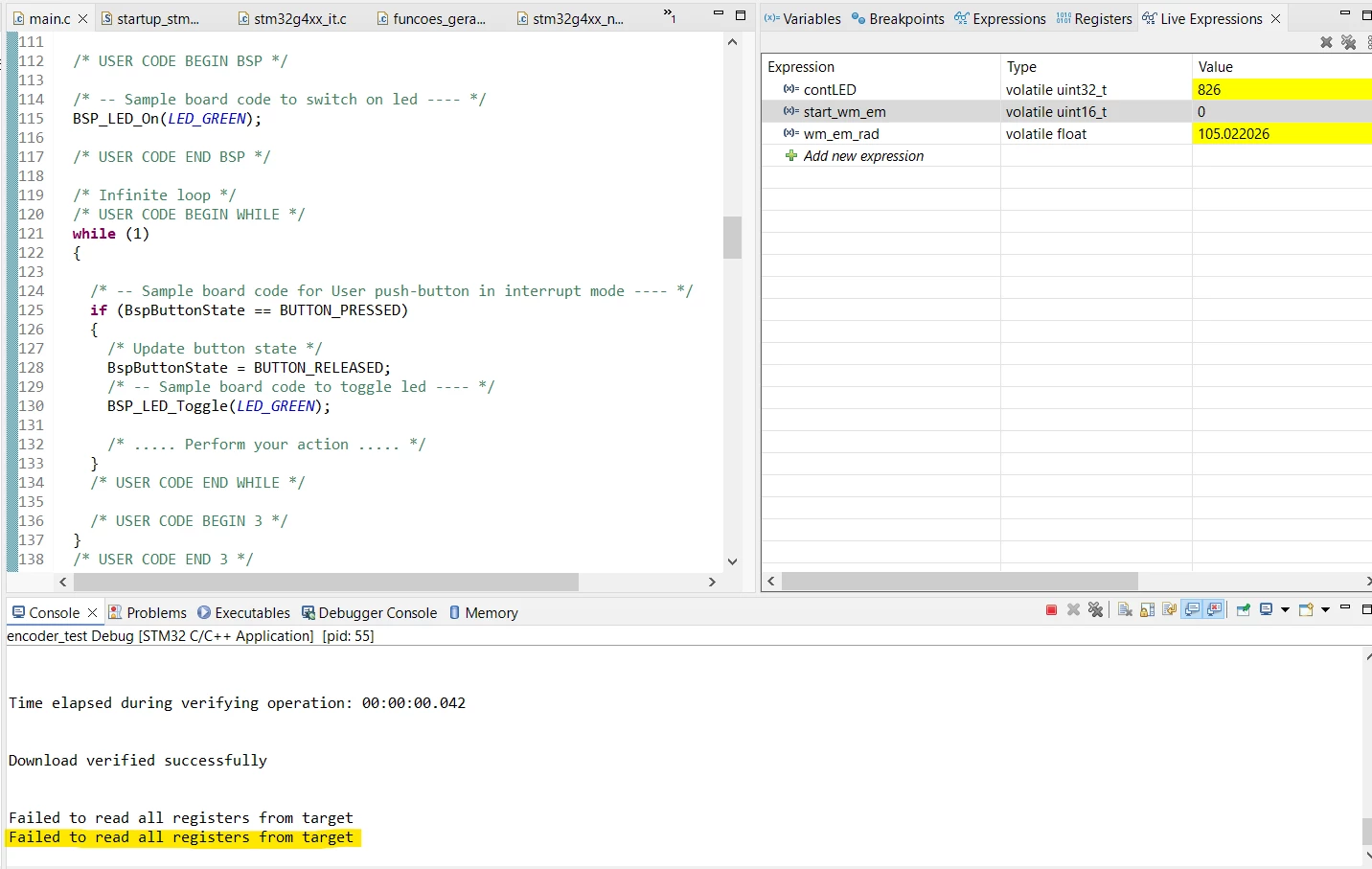

It is the same for me: since updating the CubeIDE to 1.19.0 (from 1.14), I always get the message "Failed to read all registers from target" when I modify a value in the "Live Expressions" window.
None of the solutions above helped.

I'm having the same problem; when I change a variable in free expressions, the value changes, but the message "Failed to read all registers from target" is still displayed.

Hi @franciscozussa ,
After investigation, we were able to reproduce the issue from our side with CubeIDE version 1.19.0 and ST-LINK GDB server Version 7.11.0.
The issue is reproduced with the ST-LINK GDB server started with version 7.9.0, whereas it did not exist in version 7.8.0.
This fix will be available in the coming versions of STM32CubeIDE.
Thank you for your understanding.
