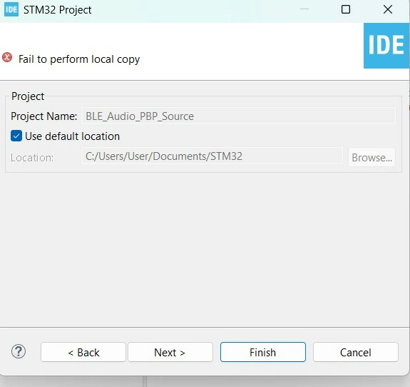

From yesterday, after selecting the example firmware for STM32WBA55G-DK1, in the final step of the process, the new warning is coming, saying "failed to perform local copy ". Kindly help me to resolve this issue.
Thank You.

Just a guess...
Disk full?
Sandeep_kAuthor
November 21, 2025
No, more than 50 GB of space available.
November 21, 2025
Hello @Sandeep_k ,
Let me thank you for posting.
Could you specify please which Cube IDE Version are you using.
I will be waiting for your feedback.
Thanks.
Mahmoud
Sandeep_kAuthor
November 21, 2025
I am using STM Cube IDE Version of 1.16
November 21, 2025
Hello @Sandeep_k ,
I reproduced your request on CubeIDE 1.19 and I successfully imported the BLE_Audio_PBP_Source Example.
Could you please try to change the default location path.
Thanks.
Mahmoud
