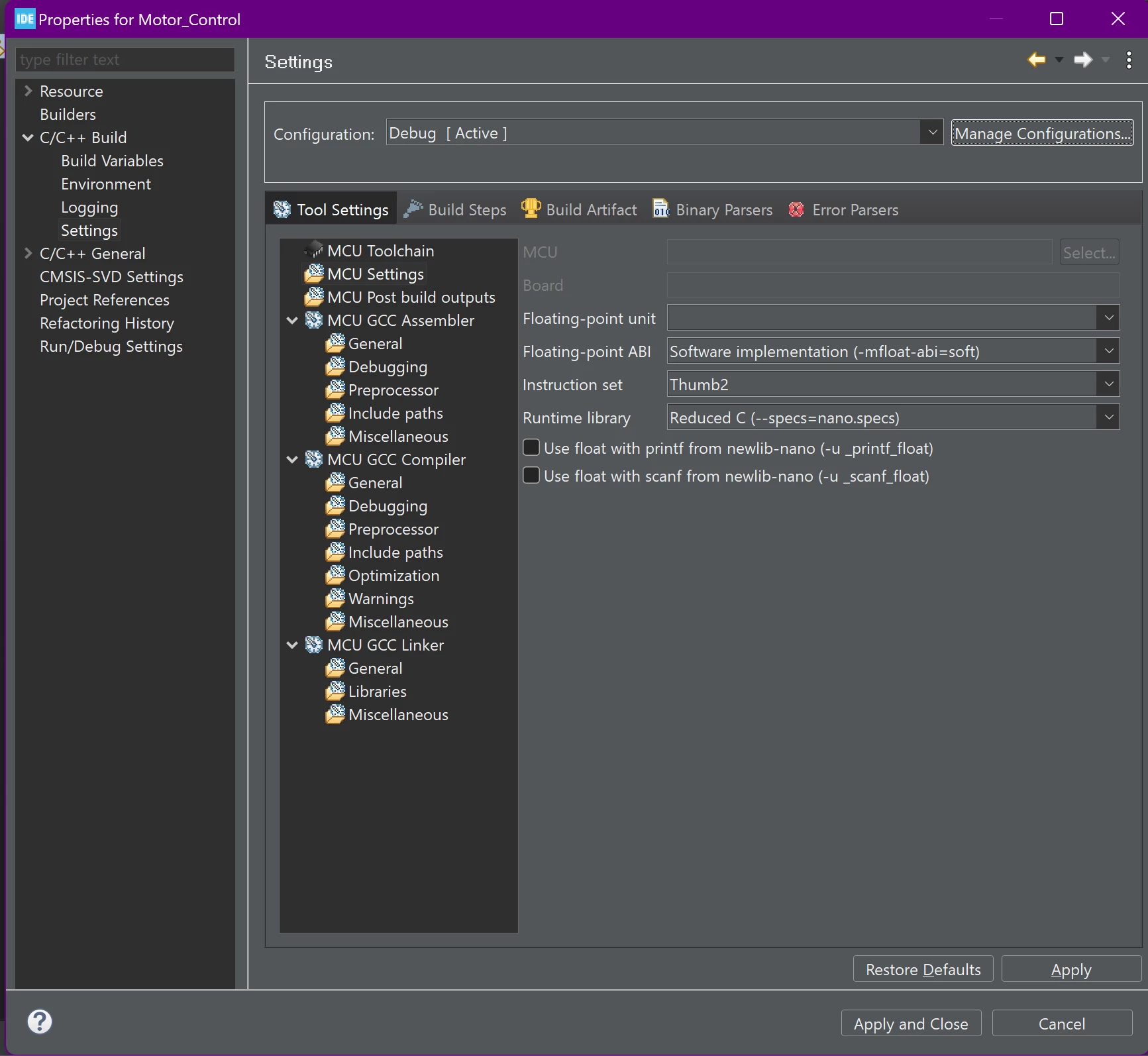

I'm new to this community. I'm having an issue right now. Everything was working fine, until I made the mistake of going to Project -> Properties -> settings -> C/C++ Build -> Settings. Silly me hit "restore defaults"

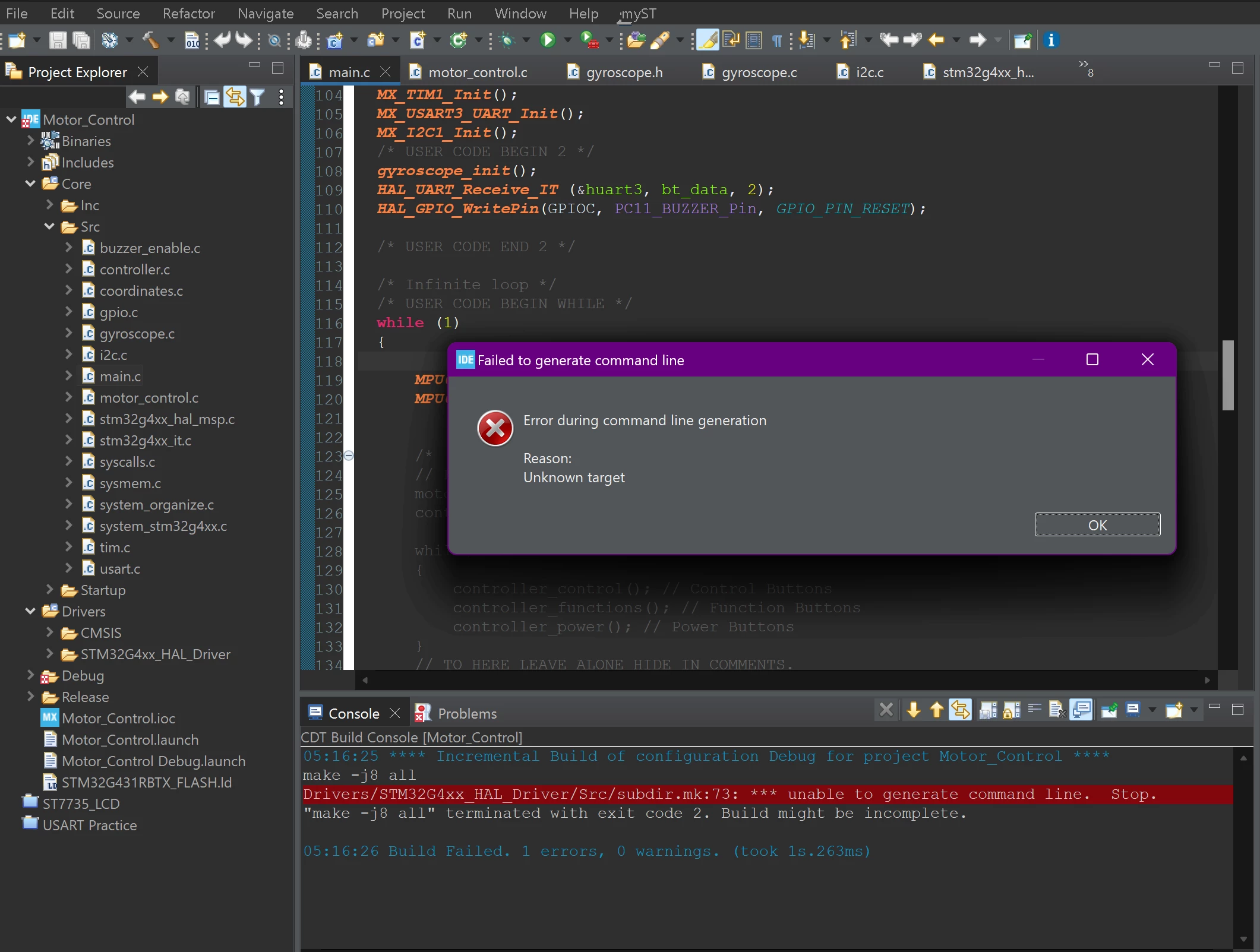

Ever since that moment, when I hit the Hammer Icon to build, I get errors that say "Failed to Generate Command line. Reason: Unknown Target".
I"m assuming somehow I deleted the linker settings somehow?
I also get these issues.
"Drivers/STM32G4xx_HAL_Driver/Src/subdir.mk:73: *** unable to generate command line. Stop."

    OK So in the end, it appears I couldn't give the STM32cubeIDE a new target, it was greyed out.
    So I selected the option to create a new project with an existing ioc file. Then dragged and dropped all the src and inc files. Seems to work now when I select build.

    I created a new file, and it appears that the HAL drivers under Debug are deleting themselves.
     Also noticed I cant get the MCU and Board options to be available how do I get that to select the board?
    Whenever I copy and paste the working new files Debug HAL drivers in, when I click build, then they get removed and that same error happens again

    You are not compiling certain source files that are under Drivers/STM32G4xx_HAL_Driver/Src. Maybe you have deleted a folder from this list.
