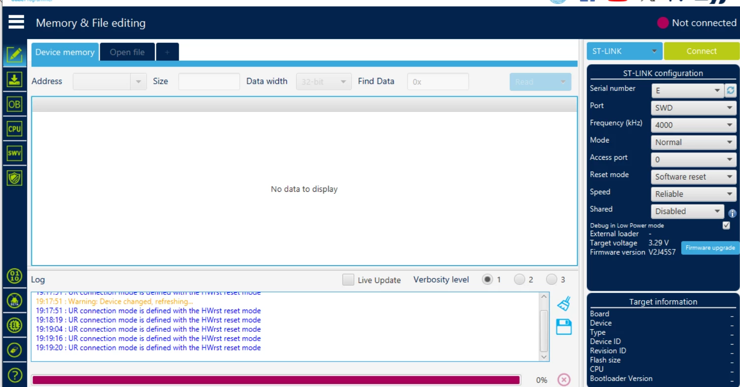

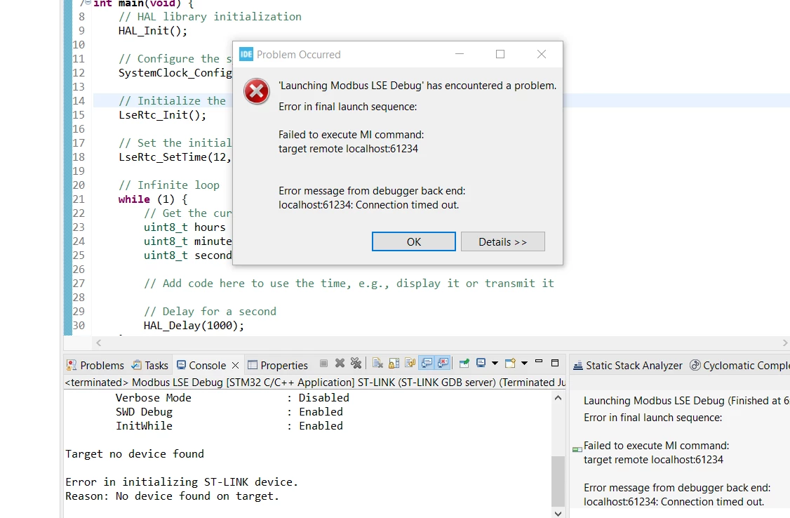

I'm new to STM32. I'm currently using STM32F103C8T6 board, and it give MI command error (image attached). I have tried using STM32 programmer as well to fix it. Still couldn't. How can i fix this?

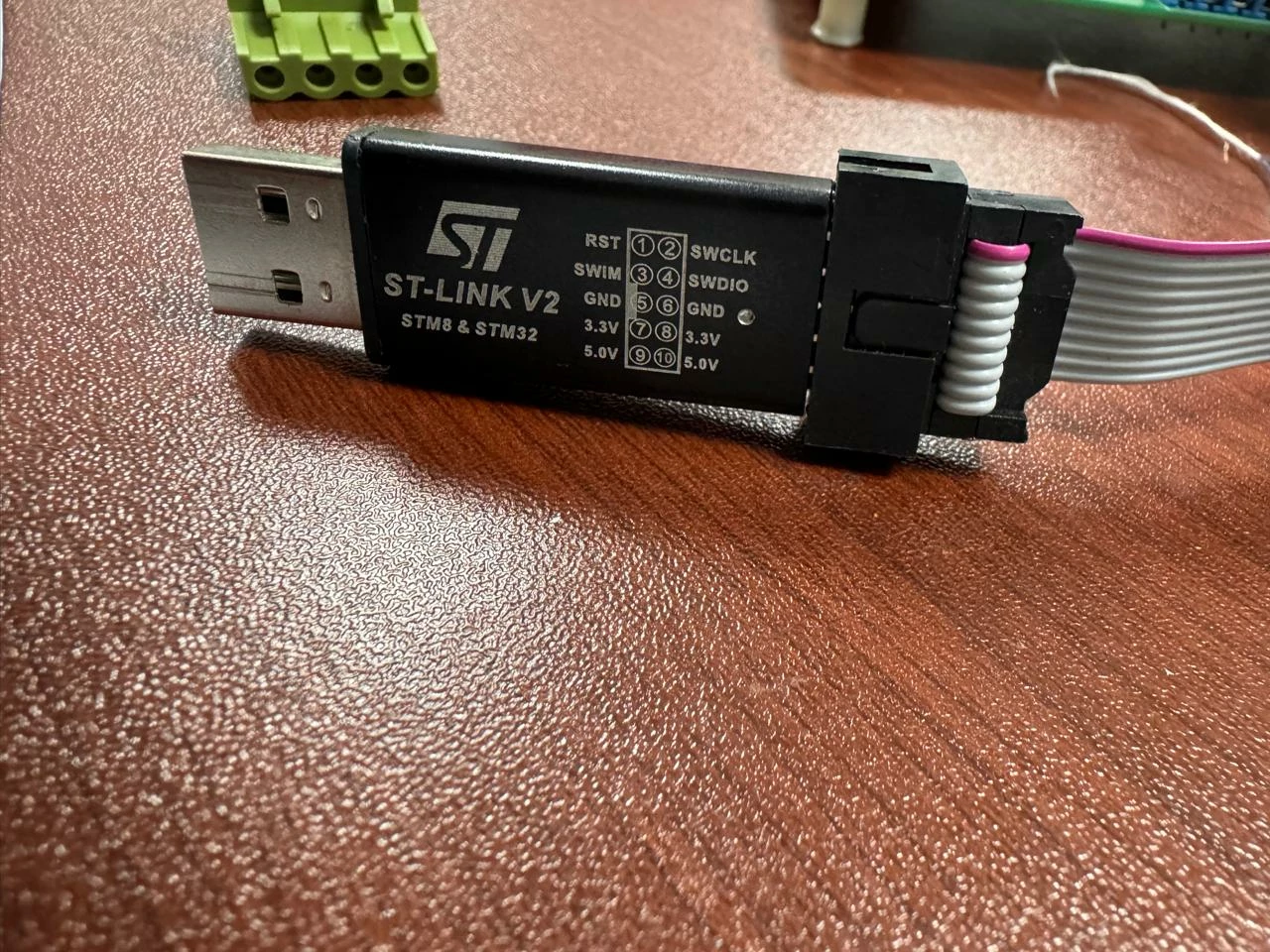

    @Thenuk__a wrote:
    I'm using ST-Link V2.
    That's a clone - not a genuine ST product.
    https://community.st.com/t5/stm32-mcus-products/blue-pill-stm32f1-board-gets-programmed-through-arduino-ide-but/m-p/668483/highlight/true#M242662
    Check your connections very carefully - different clones have different pinouts!

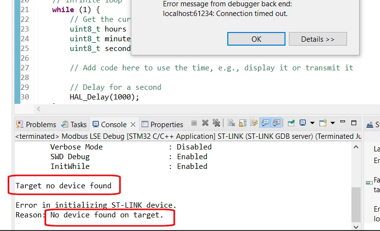

    The important part of the message is here:
    So it's not seeing your STM32.
    • Is the target properly connected?
    • Is the target properly powered?

    I have used only Arduino. The board i'm using is STM32F103C8T6. I'm using ST-Link V2.
    Thenuk__aAuthor
    August 1, 2024
    Thanks. Changed the ST link and it worked
