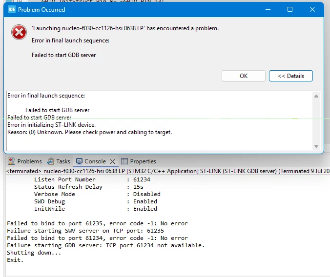

Failed to bind to ports 61234 & 61235 - again.

The problem has now recurred:
and, indeed, it does seem that the mentioned ports - 61235 & 61234 - are in an excluded range

This was working fine this Moring, so the question remains: Why has this range suddenly got excluded??

But I have checked that, and Task Manager shows no such process running
This is CubeIDE v2.1.1 on Windows 11 Pro
