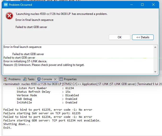

Failed to bind to port 61235, error code -1: No error
IF it’s failed to connect, and given an error code of -1, how can that be “No error” ?!
Also the suggestion “Please check power and cabling to target” is useless here - it’s not a target connection issue!
The focus of this thread is the silliness/unhelpfulness of the messages.
Not looking for solutions to the underlying issue here.

looks like windows becomes fubar after last update
do “netsh interface ipv4 show excludedportrange protocol=tcp” in console - ports will be in excluded range.
do .”net stop winnat” (needs admin rules) and check excluded ranges again
then - do “netsh int ipv4 add excludedportrange protocol=tcp startport=61218 numberofports=2” (it might prevent winnat to lock port range again) and “net start winnat”
